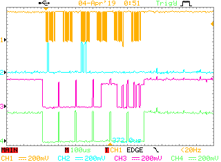

I am using a LPC159 using the SPI to receive data fro a AD7193, a 24bit ADC. What is happening is that after 24 clks, is the first 8 clks do not load anything, the next 8 clks load the hi bits and the last 8 clks load the mid bits. The lo bits are never read. If I add an additional 8 clks all 24 bits are read. This is not what the datasheet states. The bit of code for SPI capture is below and is essentially the same as the examples in the user manual. Also attached is an oscilloscope image.
Anyone have any idea?

 while(~LPC_SPI1->STAT & SPI_STAT_TXRDY);
 LPC_SPI1->TXDATCTL = SPI_TXDATCTL_LEN(7) | SPI_TXDATCTL_ASSERT_SSEL0;
 while(~LPC_SPI1->STAT & SPI_STAT_RXRDY);
 AD7193_rx_data_high  = LPC_SPI1->RXDAT;
 LPC_SPI1->TXDATCTL = SPI_TXDATCTL_LEN(7);
 AD7193_rx_data_mid  = LPC_SPI1->RXDAT;
 LPC_SPI1->TXDATCTL = SPI_TXDATCTL_LEN(7) |SPI_TXDATCTL_EOT;
 AD7193_rx_data_low = LPC_SPI1->RXDAT ;
 AD7193_rx_data = ((AD7193_rx_data_high <<(16) | (AD7193_rx_data_mid <<(8)))| AD7193_rx_data_low );
 AD7193_rx_data = AD7193_rx_data & 0x00ffffff;

In your scope of the frame I don't know which one is the data you are receiving from your ADC, so I'll suppose that in the frame you see first byte of the MISO is the data you expect from your ADC (Hi byte) and so on right?
Then yes there is a problem with the SPI, and if you can share which signal is MISO, MOSI and CLK it would help a lot.
If not, then you are processing the data in the wrong way, let's say that the first byte in MISO is thrash data, and the second byte corresponds to your ADC first byte, then in your code you'll need to ignore the first read of MISO, and take the second byte as your correct ADC first byte.
So the SPI is working as it should just the wrong way to process the bytes you are receiving from your ADC.
