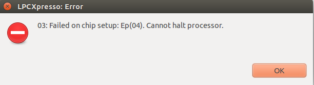

Hi Team,
I have come across the error 03: Failed on Chip Setup: Ep(04). Cannot halt processor
Before to this I have programmed the OTP memory bank 3, word 0 - Customer control data, Boot source selection as follows.
status = Chip_OTP_ProgBootSrc(CHIP_OTP_BOOTSRC_UART0);
After this I was able to use the RDK fine, able to program and debug fine.
I have modified the USB HID code clock configuration and after this I am seeing the above error. I have tried all the possible ways mentioned in LPCware and no luck :smileyconfused:.
I tried entering ISP mode by pulling P2_7 low using the user switch sw2, I see D2 & D3 (yellow, blue) LEDs glowing, is this the right indication for ISP mode?
below is the error log

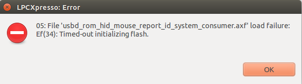

Nc: Flash Driver V.2 startup failed - rc Ef(34): Timed-out initializing flash.
Pb: (100) Writing Flash ended with an error.
Ed:05: File 'usbd_rom_hid_mouse_report_id_system_consumer.axf' load failure: Ef(34): Timed-out initializing flash.
Pc: (100) Target Connection Failed

I'm not sure what board your LPC1837 RDK is, thus I can't make any comment on LEDs. It would also be useful to perhaps know exactly which LPCXpresso IDE release you are using?
But when using an LPC18 part with internal flash, external SPIFI flash will only be executed at reset if the internal flash is empty unless you pull the ISP at boot time. But I am slightly confused by what you are trying to do here, because you talk about setting OTP bits to both boot from UART and from SPIFI. And the flash driver you are launching is the one for the internal flash, not external SPIFI.
There is more information on SPIFI flash programming at LPC18xx / LPC43xx SPIFI Flash Drivers. If you are trying to use both the internal and external flash, then you should also see Configuring projects to span multiple flash devices
If the problem is being triggered by clock setup, then the possible routes to try to recover are:
- Try manually booting the part into ISP mode before connecting. Make sure you hold the ISP pin low through the whole reset sequence, as described in  Regaining debug access to target MCU
- Use the ISP reset functionality from the debug tools themselves (if your board will support this) : ISP Reset over debug
- Try changing the "vector catch" setting in the launch configuration, which changes the way that the debugger handles pulling reset Regaining debug access to target MCU
If none of those help, then there is little more I can think of for you to try. If you were able to debug successfully previously, then I suspect that in writing to the OTP bits, you have (perhaps) accidentally locked the part for debugging - for instance by setting OTP memory bank 3, word 0 bit 31 when writing to the BOOT_SRC bits within the same word. In which case you have no choice but to switch out your chip/board. Typically writing to the BOOT_SRC bits is something you would only do towards the end of your development cycle.

4) I have lost access to board when I mucked with USB clocks, I tried   Regaining debug access to target MCU by pulling ISP pin P2_7 to low by pressing user switch sw2 on the board and tried to re-program with working firmware like a freertos_blinky example, it shows the following output
Note: I have tried changing "the "vector catch" to "true" by editing the current launch configuration"
