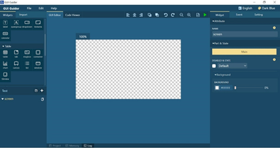

  1. Create new project
Select V8 lvgl version, LPC54S018 development board, EmptyUI, set the name and path, click Finish
Fig.1

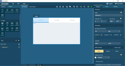

  1. Set the overall background
Drag Widget Tab to the GUI Editor, and resize it to full screen size.
Fig.2

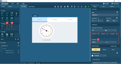

  1. Add time display and to-do functions.
1) Change the Tab Content1 name to Clock in the red box on the right.
Fig.3

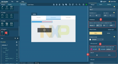

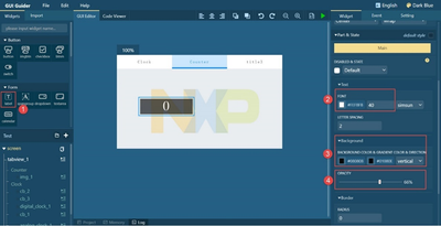

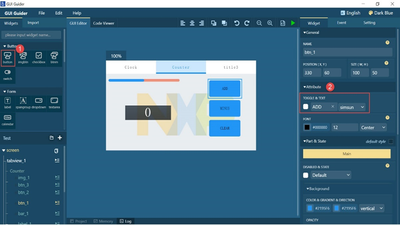

2) Add count value, progress bar and button. Figures 8, 9 and 10.
In Figure 8, when adding a progress bar, set the starting value in the second step. The range value of the progress bar is set by lv_bar_set_range(guider_ui.screen_progress_bar, 0, 100) which can be added to a key event, executing on every click. Therefore, it is recommended to add this code to the subsequent export file costomer.c, and set it once during initialization.
Fig.8
Fig.9
Fig.10

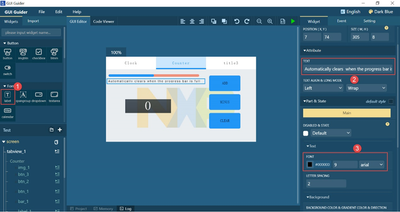

3) Add some explanatory text to the progress bar. The operation steps are shown in Figure 11.
Fig.11

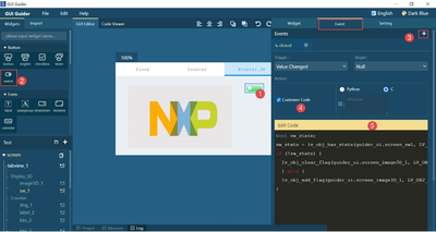

4) Create an event in the corresponding button, select Customer Code, write the corresponding code, and complete the interaction. Take the ADD button as an example, as shown in Figure 12.
Fig.12

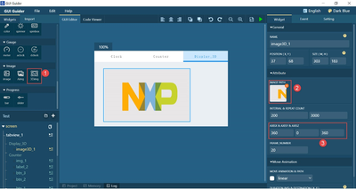

  1. In the Tab third content, 3D animation effect is shown.
1) Set the 3D picture. Select 3Dimg, drag it into the editor, set the image in the image path, and then select the rotation center and rotation angle, as shown in Figure 13.
Fig.13
2) Set the display switch. Turn on the switch to display the 3D picture, and when the switch is turned off, the picture disappears. Such as Figure 14.
Fig.14

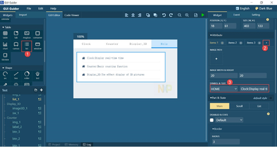

  1. In the fourth Tab content, add “help”.
1) Add logo. Add img, import image to set transparency.
Fig.15
2) List the first three modules. Drag the list Widget into the editor, create new lines and modify pictures and texts.

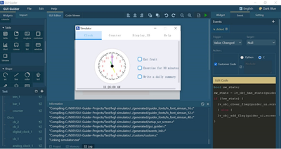

After completion, generate the code as shown in Figure 16. The results can be directly displayed by simulation or imported into the development board. Figure 17 shows the simulator and selectable target. The simulation results are shown in Figure 18.
There are two ways to download the design to the development board. One is to select the available IDE in Figure 17 and download it directly through GUI Guider. The second is to export the source files first, replace them one by one in the relevant SDK demo code, build with application code in IDE and download/debug with IDE debugger.
