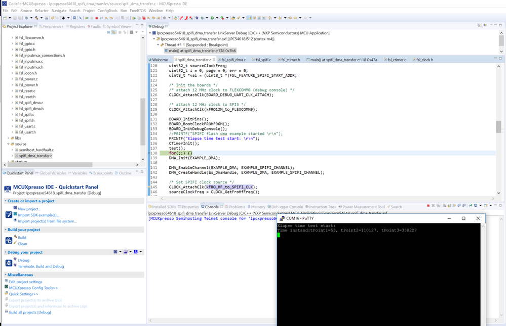

Sometimes, It is required to test the time which an api function takes when the function is executed, for example, some users want to test the flash erasing time and flash programming time. User can use GPIO to set/clear and use scope to test the GPIO timing to measure the time an api function takes, the method is very simple and straightforward but inaccurate.
The document describes to configure CTimer as a 32bits  free-running counter, user can read the counter value before and after an api function and compute the counter value difference to get the time the api function takes.
The CTimer of LPC54xxx family counts the APB bus clock, the APB bus clock Is driven by 12 MHz FRO, user can use the following code to measure the elapsed time.
For example, we test the elaped time of  delayTimer(10000); function, we get the variable tPoint1, tPoint2. The actual time is (tPoint2- tPoint1)*(1/12000000).
In the example, the tPoint2=110127, the tPoint1=53, the elapsed time is (110127-53)*(1/12000000)=9.172us.

     PRINTF("Time instand:tPoint1=%d, tPoint2=%d, tPoint3=%d \r\n",tPoint1,tPoint2,tPoint3);
Snippet of simple source code based on MCUXpresso tools and LPC54618 board developed by XiangJun Rong
