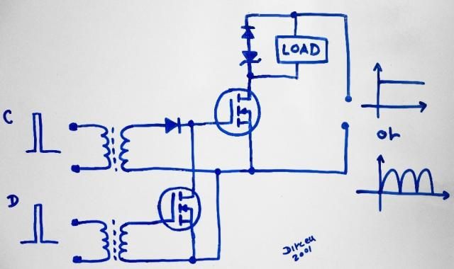

The circuit is implemented with pulse transformers (20 kHz PWM frequency) using the gate-source capacitance as memory. A Schottky diode avoids the stored charge to leak through windings. Thus, it's possible to achieve duty-cycles near to 0 and 100 %, simply applying 1 µs pulses shifted in time - one for charge, other for discharge. A very simplified schematic is shown in Figure 1.
      Figure 1. Simplified circuit.

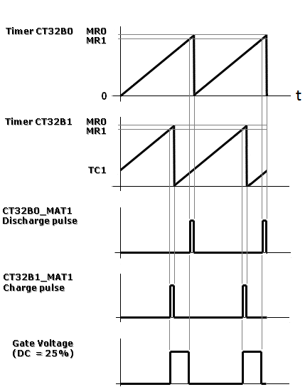

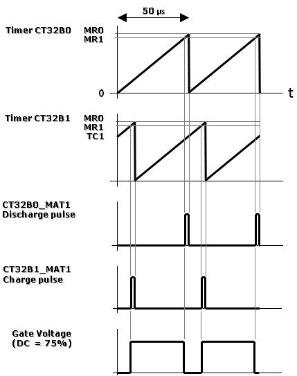

My solution for the LPC1114 - Cortex-M0, uses two timers in a different scheme: Phase-out or lead/lag the counter values. With CT32B0 and CT32B1 32 bit timers, the behavior, including the pulsed outputs, is better understood looking on Figures 2 and 3 for duty-cycles of 75% and 25%. As opposed to common solutions, for each timer, the MR0 and MR1 matching registers values are constant. The difference between them is equivalent to pulse width (1 µs).
The MR0 value also defines the period. The duty-cycle it’s determined through the expression:
DC = TC1 / MR0
(1)
Where, TC1 is the CT32B1 timer value when this one, for the CT32B0, is zero.      In order to change the duty-cycle, the code in foreground task establishes a new TC1 and enables the CT32B0 overflow interrupt, where  this value is effectively loaded on CT32B1 timer in a safe point (to avoid jitter and other dangerous edges on outputs). Also, the CT32B0 ISR disables itself at the end, ensuring low interrupt overhead. For safety, the first applied pulse is a “discharge pulse”. This solution was proven driving a 930 W (120V/8.7 A) single-phase induction motor and it can be seen in reference [1], using a synchronous AC version of circuit shown in Figure 1 (no diode, four mosfets).
148727_148727.jpgFigure 2 LPC1114 Two Pulses Gate Drive solution - DC 75 percent.jpg
     Figure 2. LPC1114 Two Pulses Gate Drive solution - DC 75%.
Figure 3. LPC1114 Two Pulses Gate Drive solution - DC 25%.

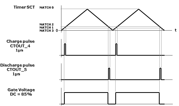

Despite this difference be constant, now the MATCH 2 and MATCH 1 contents must change at the same time. Figures 4 and 5 show the waveforms for duty-cycles 15 % and 85 %. For example, the duty-cycle can be determined through the expression:
DC = 1 – (MATCH 1 + 0.5*PULSE_WIDTH )/ MATCH 0        (3)
Figure 4. SCT Two Pulses Gate Drive solution - DC 15%.
Note: In companion source code, the PULSE_WIDTH is referred as PULSE_LENGTH.
Figure 5. SCT Two Pulses Gate Drive solution – DC 85%.

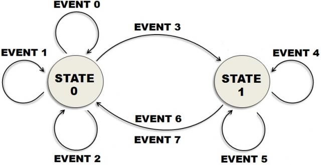

In order to achieve this behavior, one simple Finite State Machine with two states has been defined (Table 1):
STATEMeaning
0CTOUT_4 pulse generation
1CTOUT_5 pulse generation
Table 1. Definition of states.

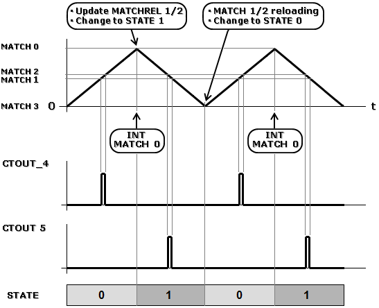

Figure 6 illustrates the relationship between the counter, states and interrupts. The PWM updating scheme takes advantage of following SCT property (as stated on User Manual): “A MATCH register is loaded from the corresponding MATCHREL register when BIDIR is 1 and the counter reaches 0”.
In this application, the ADC0 interrupts MCU in a 24 Hz rate, triggered by TIMER0 MR0 (EM0 rising edge). The code on this ISR determines the new MATCH 1, saves it on global variable match1 and enables the SCT interrupt associated with event “counter reach limit” - in fact, event for MATCH 0. Here note, as stated in expression (3), that DC depends only on MATCH1, since MATCH 0 is constant. The ISR code for MATCH 0 event, updates MATCHREL 1 and MATCHREL 2 registers based on variable match1. Also disables the associated interrupt for low overhead. When counter reaches 0, the MATCH 1, 2 registers will be reloaded from the MATCHREL 1, 2 values automatically. This procedure should avoid jitter and other dangerous edges on outputs.
Note that MATCH registers are never handled by software when counter is running. The new desired values are indirectly loaded on MATCHREL registers. The first values for MATCH registers are intentionally unreachable (> MATCH 0). This ensures that only ADC readings brought useful values to them.
The on board potentiometer generates a voltage from 0 V to 3.3 V, which translates to 0 – 1023 range by the 10 bit AD converter. The MIN_MATCH1 and MAX_MATCH1 predefined values equates to 36 and 1116 (equivalent to duty-cycle 5 % and 95 % DC). Therefore, the software relates ADC0 voltage to with match1 variable approximately through the expression:
match1 = [(MAX_MATCH1 - MIN_MATCH1)*ADC0] / 1024 +            (4)
                                                 MIN_MATCH1
Note: In the companion source code, the division by 1024 is performed with a 10 bit right shift.
Figure 6. PWM updating scheme - DC 50%.
Table 2 lists the eight states comprising the state machine for the current application. The companion state transition diagram is showed on Figure 7. Here, note other SCT important property, as stated on User’s Manual: “If more than one event associated with the same counter occurs in a given clock cycle, only the state change specified for the highest-numbered event among them takes place”. This applies to events 6 and 7. In normal operation, the event 6 happens periodically in State 1; but when a pushbutton press causes a low level on CTIN_6, the event 7 is fired on State 1 and counter is stopped. The state is driven to 0, with the outputs cleared (until one falling edge on CTIN_2 initiates the counting).
EVENT IDHappens in stateConditionsActions
00Falling edge on CTIN_2Start counter
10Counter reach MATCH 1
when counting up
Set CTOUT_4 (pulse rise)
20Counter reach MATCH 2
when counting up
Clear CTOUT_4 (pulse fall)
30Counter reach MATCH 0Limit counter (defines the half period)
Int. to update MATCHREL 1/ 2
Change to STATE 1
41Counter reach MATCH 2
when counting down
Set CTOUT_5 (pulse rise)
51Counter reach MATCH 1
when counting down
Clear CTOUT_5 (pulse fall)
61Counter reach MATCH 3 (0)MATCH 1/ 2 automatic reloading
Change to STATE 0
71Counter reach MATCH 3 (0)
AND
Low value on CTIN_6
Stop counter
Change to STATE 0
Table 2. Definition of states.
Figure 7. State transition diagram.
