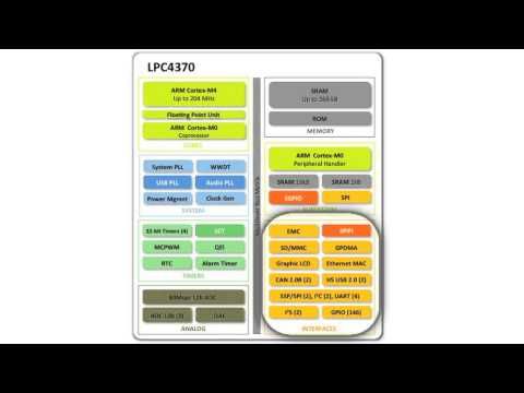

LPC4370
The LPC4370, ARM Cortex-M4F based microcontrollers, are complete data acquisition solutions on a single chip. The LPC4370 provide the fast digital and analog inputs, the high performance processing capabilities, and the hi-speed output needed for data acquisition applications. Running up to 204MHz, the ARM Cortex-M4F of the LPC4370 is the industry’s fastest Cortex-M microcontroller. The Cortex-M4F is a next generation 32-bit core that offers system enhancements such as low power consumption, enhanced debug features, and a high level of support block integration.

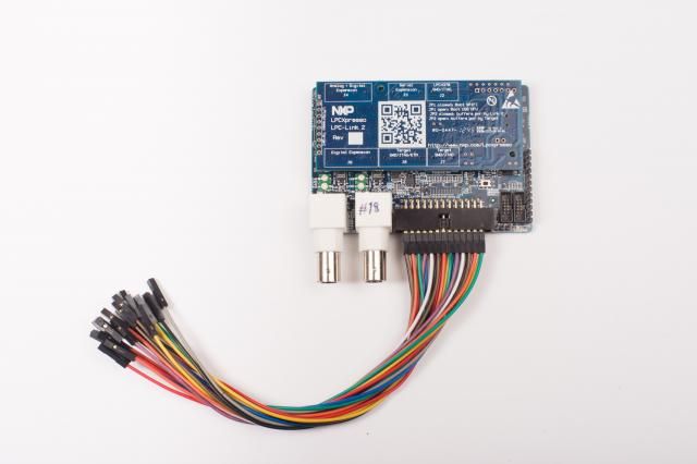

LabTool
LabTool can be purchased as a kit that includes the Link2 main board plus the add-on board, or the two can be purchased separately.  A connector with 26 probe wires is included, and is the only accessory required for using the tool.  The probes feature a 2.54mm pigtail end, for easily connecting to headers and jumpers on a target platform.  A set of compatible microgrippers may also be useful, but must be purchased separately.

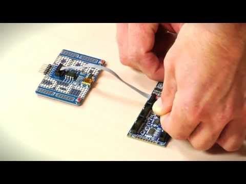

Watch the video here.

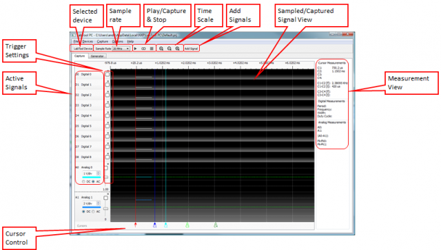

GUI
LabTool comes with a feature rich software interfaced developed by Embedded Artists.  The GUI gives users the capability to manage the digital and analog channels through:
  • Dialogs for selecting digital and analog inputs channels
  • One-shot and continuous sampling
  • Sorting and moving of signals
  • Applying application-specific signal names
  • Saving settings in a project file
  • Exporting collected data to .csv formatted files
  • Appling SPI, I2C or UART protocol analyzers to selected channels
  • Using four cursors to measure and interpret waveforms

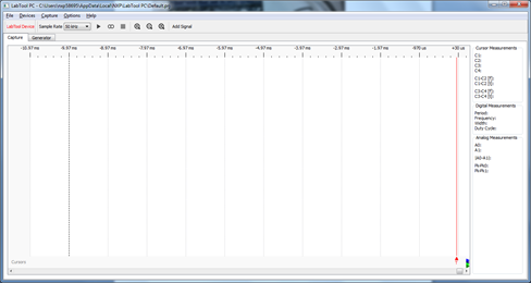

  • Once the GUI is running, check that “LabTool Device” is displayed in the section marked “Selected device” in the diagram above.
  • The probe bundle has each wire function labeled on the silk screen of the PCB.  Check these carefully to find cable D0, and connect it to the demonstration signal  labeled “PWM_LED” on the header at the bottom right corner of the board.  In the GUI, choose “Add Signal” and select D0 as an input channel; press OK.  Set a falling edge trigger and a sample rate of 2MHz.  Choose continuous sampling, and view the results in the waveform view.  It’s that simple!
Correct Orientation
Correct orientation is required.  Be sure the expansion headers on the Link2 are aligned properly to the connectors on the LabTool add-on board.  The USB port is located at the end opposite from the BNC connectors.

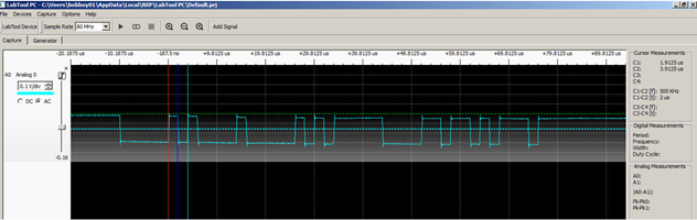

CAN on one channel:
1)    500 kHz is correct !
2)    The waveform (at 80 MHz) is good – the overshoots are not visible on the HP but I didn’t adjust the tiny capacitor screws on the LabTool.  There are more of the resolution errors shown on the rise and fall edge than my HP – but HP still has some.  Not a big deal.

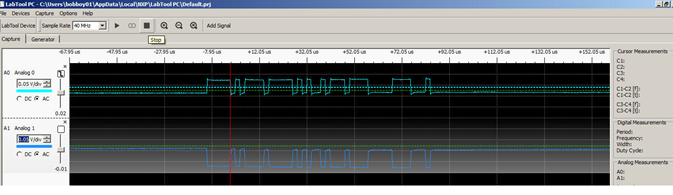

Here is the CAN frame using two channels:  Even though I had to reduce the sampling freq to 40 mHz – it still looks good.
The ability to move the waveforms vertically (and maybe a polarity switch) would be nice.

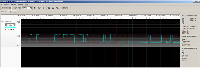

SWO:
Very often customers must measure the frequency on the SWO pin if they can’t get the Serial Wire Viewer (SWV) working and they do not know what their CPU clock is.
A scope makes this easy and – LabTool did very good – I think sometimes the SWO pin can go up to 1 mHz and more – but this example at 1.25 worked fine.
1.25MHz as shown here is correct !

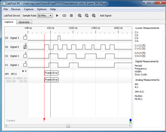

Using the SPI Protocol Analyzer
Lately I’ve been working with one of NXP’s solution kits.  This kit includes an LPC812 Xpresso board and a daughterboard with the SEN300 sensor.  The sensor measures temperature, humidity and light.  It interfaces the microcontroller through a 4-wire SPI bus (SCK, MISO, MOSI, CS) running at 300kHz.
Considering that an end user of this solution kit may want to add another node on the SPI bus, it should be necessary to increase the communication rate from 300kHz to a higher speed, and allow for transfers to/from the additional device using the same SPI peripheral.  Types of SPI devices that could be considered are a simple LCD for displaying the sensor readings, or an EEPROM for data logging.
After I selected new dividers for the SPI master clock to increase the clock rate to 3MHz, the communication interface broke down.  I setup the LabTool digital interfaces D0 to D3 and configured the SPI protocol analyzer to use these for the corresponding SPI signals.  Following are some screen shots and the conclusion of the problem.
Normally the communication seemed to be occuring just fine.  I noticed that the chip select signal (Digital 3) was active low outside the boundaries of the waveform view in the LabTool GUI. From time to time, actually more often than not, the SPI analyzer could not interpret the transfer data, and showed “Frame Error” was occurring.   By changing the trigger to the rising edge of the chip select, I could see this occurring more frequently.  At that time, the chip select signal was momentarily toggling high/idle and then low/active in the middle of a data transfer.
I began stepping through the code to find the routines that set and cleared the state of the chip select (a simple digital output port).   I found that the routine that handles the SPI transmit/receive buffers could get out of sync with the function controlling the chip select output, and cause message transfers to overlap.  By adding some simple logic to ensure the chip select was not idled before the SPI buffers were serviced, the problem went away.  Here is a screen shot of a good SPI transfer at the higher SCK rate.
Using LabTool and the SPI protocol analyzer feature, I was able to identify the problem in the communication interface, and then use a debugger to finish checking the root cause.

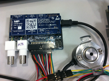

Motor control applications often use the feedback from a rotary encoder in a closed loop control system.  The LPC4370 microcontroller includes a QEI peripheral (Quadrature Encoder Interface) that decodes these signals directly.  By monitoring both the number of pulses and the relative phase of the two signals, you can track the position, direction of rotation, and velocity.  In this example, we’ve measured the QEI signal sequence with LabTool.  The type of Rotary Encoder used in this project is SXA-4EG05E1024BM with 1024 pulses per round.
The encoder ouputs A,B and Zero terms. So we connect the encoder with LabTool through DIO0~DIO2. LabTool should also be connected with the Encoder’s gound pin to ensure they share a common gound.  Use one of the available grounding probes on the 26-pos connector (e.g. probe #4), to make this connection.
DIO0 -> A Term
DIO1-> B Term
DIO2-> Zero

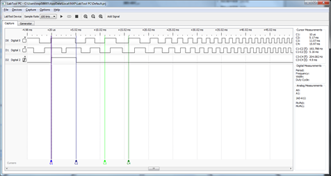

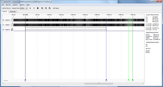

Open the LabTool application program on your PC, and connect the LabTool using the USB connection.
The GUI will show that LabTool is connected when the text "LabTool Device" changes from red to black text.  Now, you can click the “Add Signal” button and choose D0, D1 & D2 digital signals as below picture shows.
We’ll rotate the Encoder by hand, so we set the “Sample Rate” as 100kHz.
Set the D2 Digital capture on rising edge.145809_145809.pngMIXED-SIGNAL-LOGIC-ANALYZER-OSCILLOSCOPE-SOLUTION-15.png
Click the “Capture->Continuous” or 145810_145810.pngMIXED-SIGNAL-LOGIC-ANALYZER-OSCILLOSCOPE-SOLUTION-16.png button to start sampling the digital input channels.  When we rotate the Encoder, the signal capture below is displayed with LabTool.
We can move the triggers C1&C2, C3&C4 to measure the signal’s frequency and duty cycle.
If we want to measure a whole cycle from the Encoder, we can set the “Sample Rate” as 50Mhz, then rotate the Encoder and capture the entire waveform shown next.
LabTool's logic analyzer feature is very powerful and useful for motor control applications measurng the feedback from a rotary encoder.

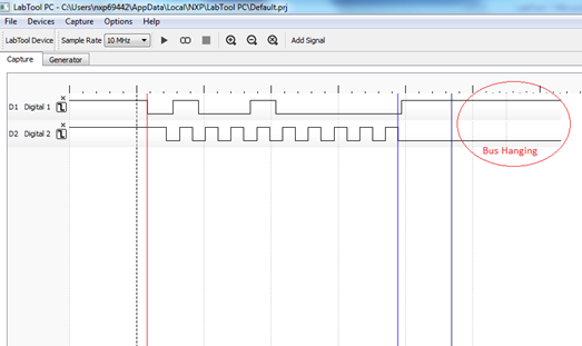

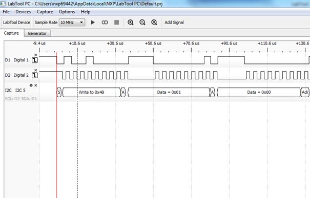

Investigating I2C/SMBus issue using LabTool
One of our customers is designing-in the NXP Microcontroller in a SAS (Serially Attached SCSI) Server system. This controller is used to manage the overall backplane activities and interfaces to the host SAS Controller on SMBUS/I2C Bus. The customer was facing major issue of I2C Bus hanging.  As such, it was difficult to diagnose the issue as there were multiple slave devices on the bus. Coincidently, we had this LabTool lying around and I thought of using it in debugging the issue. Initially, I isolated this controller from the I2C bus and hooked it up to another I2C Master. While monitoring the bus activity on the LabTool’s I2C Analyzer, apparently the overall communication was just fine as shown below.
On a closer look, I noticed that the clock (SCL) was getting stretched a bit at times, but nothing unusual. I then connected this controller back in the system and monitored the I2C bus activity on I2C Analyzer again. And no surprise, the bus hanging problem was getting reproduced as seen in the capture below. After the clock stretching interval, the clock (D2=SCL) line was holding it’s status as low and data (D1=SDA) was high. It was clear that the problem appears only when there are multiple slaves connected to a SMBUS/I2C Bus Master.
It gave me some direction to think and investigate more on similar lines. Gone through the details of SMBUS/I2C peripheral on SAS Controller and as usual googled for I2C issues with multiple slaves.  Finally got a clue while going through the minute details of SMBus specifications. Though it’s normal to use I2C slaves/devices with SMBus master and vice a versa, there are subtle differences in the specifications. The most vital difference is the Timeout and (as a consequence of timeout) minimum clock speed. There’s no time out in I2C specifications, any device can stretch the Clock as long as it wants. While the SMBus clearly specifies the time out of 35msec, where slave devices resets their interfaces whenever Clock goes low for longer than the timeout. Use of such timeout also dictates a minimum speed for the clock, because it can never go static. Thus, the SMBus has a minimum-clock-speed specification of 10kHz.
To comply with the SMBus specifications Slave devices should have this time out implemented. I then added a small piece of code to generate this timeout using one of the available timers and that resolved the issue. Thanks to the LabTool!

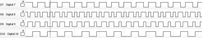

I did a zoom in the PWM signals in order to get a more detail measurement and I will compare these signals measurements with the AnalyzerB tool.
  • D7 is 2MHz
  • D8 is between 3.33MHz and 5MHz
  • D9 is between 3.33MHz and 2.5MHz
  • D10 is between 1.42MHz and 1.66MHz
I had these measurements because the sample rate is at 10MHz and LabTool is using the upper channels. Now I did a measurement using AnalyzerB tool.  It couldn’t read the 12MHz signal (channel 0); the sample rate is at 12MSPS. I had to increase to 24MSPS (MAX) in order to be able to measure the 12MHz signal. The frequency measurement in each signal was exactly 1.5MHz channel 3, 3MHz channel 2, 6MHz channel 1 and 12MHz channel 0 without any variation.

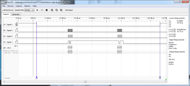

Now, using the LabTool I change the 4 PWM signals to channels 0 to 3 and increase the sample rate up to 100MHz. I had the following:
The frequency in the signals is:
  • D0 is 12.5MHz and 10MHz
  • D1 is 6.25MHz and 5.55MHz
  • D2 is 2.94MHz and 3.12MHz
  • D3 is 1.51MHz and 1.47MHz
The AnalyzerB tool didn’t show any variation in the frequency measurements. It might be because the LabTool has more precision. I went up to 100MHz sample rate and I had the same frequency measurements in each signal. Maybe the AnalyzerB is using some other method to implement an average or it might be over sampling to improve the measurement. I might need to have a third logic analyzer to see what tool is getting a right measurement.
