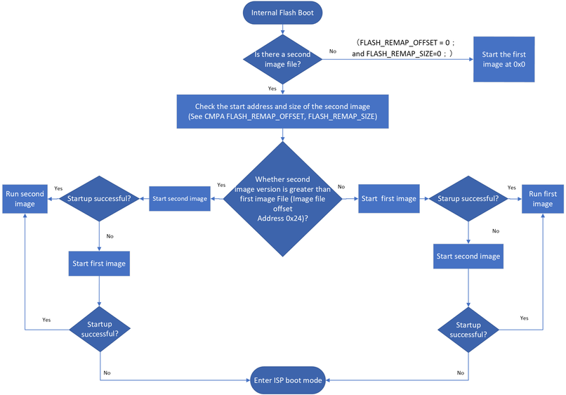

LPC5536 ROM supports the dual image boot for internal flash, that means, in the flash region, two boot images can be placed there; ROM decides to boot which image based on the image version, boot the one with the newer image version first, if fail, boot the older one.
During power-on and startup, the ROM first detects the location and size of the relocated image file in the CMPA, and then detects the version number of the two images. Therefore, when the dual image is used,  mainly need configure the relocation address and version number of the image files.
The internal flash boot flow for dual image is as follows:

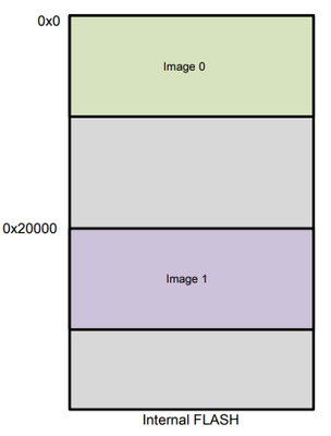

2.1 Relocating Image File
The LPC5536 internal flash supports remapping. When set the remap offset, Internal FLASH memory AHB access will change the access address adding the offset as the below figure shows. For example, when the offset is set to 128K(0x20000), the access to 0x0 will be remapped to 0x20000. Via this IP feature, ROM can implement a dual image boot with two images. The offset and the remap size of the image is set in CMPA region by the user.
This is an illustration of two image files stored in internal FLASH.
The offset and remap size of the second image is set by the user in the CMPA area to let ROM know the location of the second image.

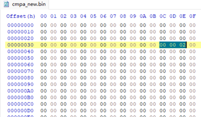

Use blhost to write the modified bin file to CMPA to configure the image1 offset and remap size. The procedure is as follows:

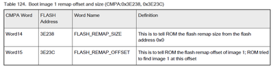

First, open an all 0 cmpa.bin and change the data at 0x3E23C to 0x20000, as shown in the figure below:
Then, modify the remap size. The data at address 0x3E238 is changed to 0x1d800, as shown in the following figure:
Modify and save, rename as cmpa_new.bin, save as \blhost_2.6.7\blhost_2.6.7\bin\win.

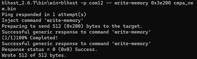

Program modified bin file into CMPA.
Write CMPA by using command blhost-pcom12 -- write-memory 0x3e200 cmpa_new.binas shown below:

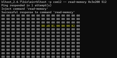

Read back CMPA data after writing.
To confirm the accuracy of the data, run command “blhost-pcom12 -- read-memory 0x3e200 512” to view the configured CMPA data, as shown in the following figure:

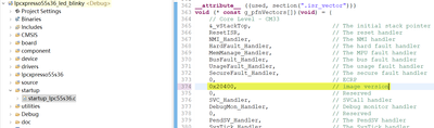

In Image0 project, set version number to 1, in Image1 set version number to 2:
Open the project of red light blinking and change the header file to 0x10400 at offset 0x24.
Open the project of blue light blinking and change the header file to 0x20400 at offset 0x24.

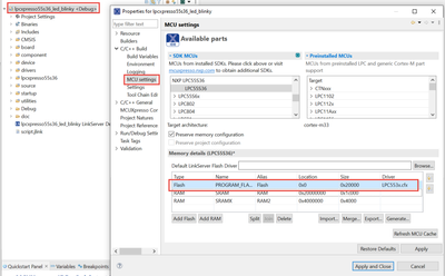

For users, LPC5536JBD100 has a total of 246K internal flash available, so Image0 is assigned to the address range 0x00000-0x1FFFF and Image1 is assigned to the address range 0x20000-0x3D7ff. If using MCUXpresso ID, the Settings are as follows:
Right-click Selected Project -> choose Properties ->MCU settings, set the Location (start address) and Size, click  Apply button when finished.
The red light blinking project are modified as follows:
 The blue light blinking project modified as follows:

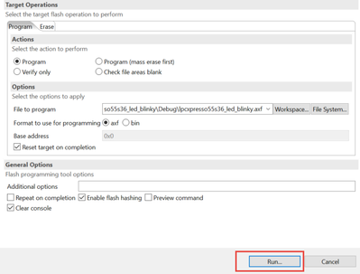

Download Images:
Using GUI Flash Tool in MCUXpresso IDE, download two image files to the development board:
Open, and the following view pops up. Select download File in "File to program", then click run button, image will be downloaded to flash.
When the download is complete, click OK.
Download another image in the same way. Note that "mass erase" cannot be checked when programing the second image. If you use other tools to program, also should disable the same function as "mass erase", avoid erasing the first image file.
