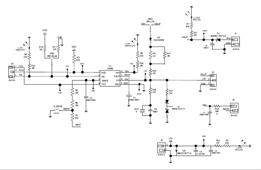

      LIN bus voltage is 12V, but the LPCXpresso54608 board don’t have the on board LIN transceiver, so we need to find the external LIN transceiver, then connect the LPC54608 UART port to the LIN transceiver. About the external LIN transceiver, we use the NXP official LIN driver board KIT33662LEFEVB, this board schematic can be found from this link:
https://www.nxp.com/docs/en/user-guide/KT33662UG.pdf
         Fig 2-1. LIN transceiver schematic

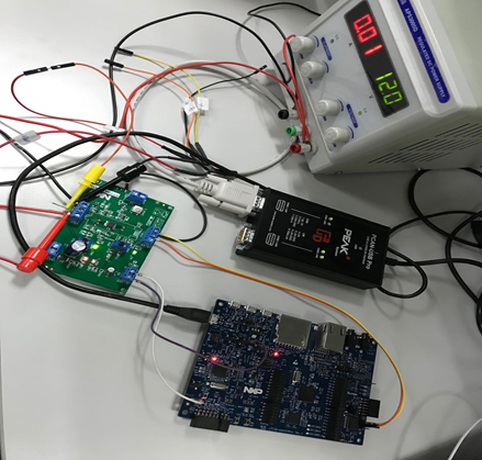

2.1.4 Physical connections
               Fig 2-2. Physcial connections

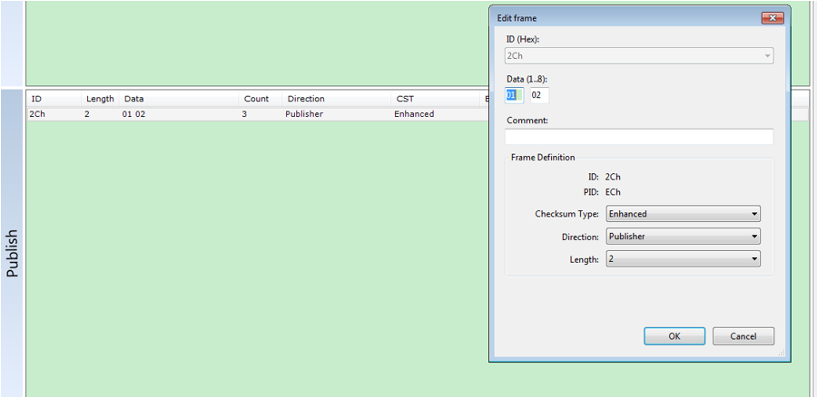

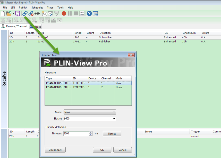

3.1 LIN slave configuration
The LIN baud rate is defined as 9600bps. The following picture is from the LIN analyzer (PEAK LIN tool) software:
To get the data from the LIN slave, the master need to send the 0x2C frame at first, then the slave will send back the according data. The master subscriber frame is the slave’s publisher frame; the master publisher frame is the slave’s subscriber. Master send, slave receive. Master receive, then the slave is the send side.
      In the slave software side, need to configure the 0X2C ID according data, then press the space key, the slave will wait for the master’s according frame.

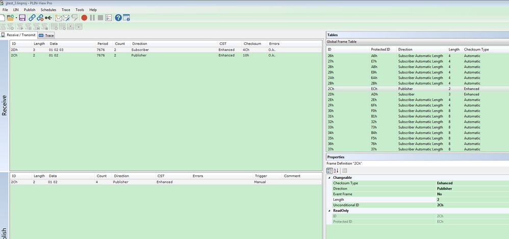

3.2 Send 0X2C and 0X2D frame
From the slave side, we can find 0X2D is received successfully from the master, 0X2C can send the correct data to the master.

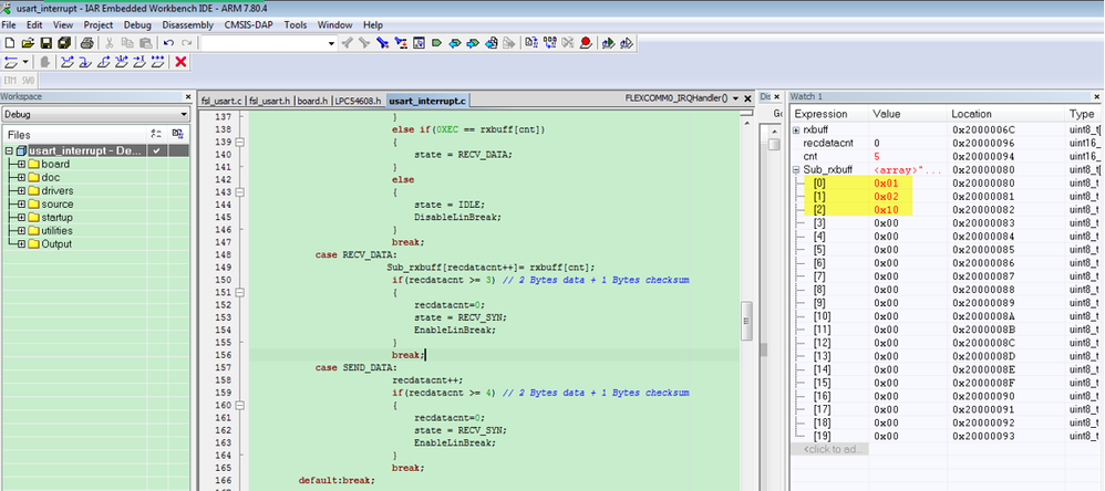

3.2.1 0X2D frame data LIN bus wave and debug result
Yellow wave is the LPC54608 UART TX pin wave.
Blue wave is the LIN bus wave.
From the LIN bus wave, we can find that the LIN master can send out the correct LIN data, and the checksum also correct from the slave received side.

From the wave, we can find that after the LIN master send the 0X2C data, the slave will send back the according data to the master, now check the LPC54608 debug data from IAR:
From the received data and the checksum data,  we can find the slave feedback is correct.
So, the above modified code can realize the LPC54608 LIN master frame basic send and receive function.  Next time, I will also share a post about the LPC54608 LIN slave code.
