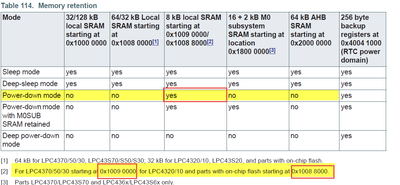

As shown in the manual, only 8kB local SRAM will not lose power in LPC43xx series Power-down mode.
Note: Chips with and without internal flash have different 8K SRAM address ranges.
For LPC4330/LPC4350/LPC4370 series products without internal flash, the 8K SRAM address range is 0x10090000– 0x10092000 (8KB). The address range of chips with internal flash such as LPC4337/LPC4367 is 0x10088000 – 0x1008A000 (8KB).
Placing data in this 8K SRAM area can solve the problem of lost data.

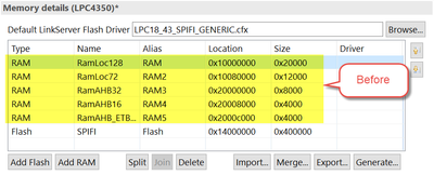

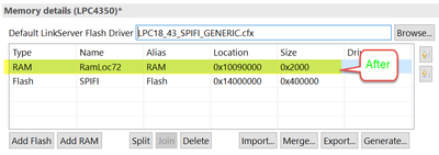

Taking LPC4350 as an example, the setting method in MCUXpressoIDE is as follows:
  • Find the following interface according to Project \ Properties \ C\C++ Build\MCU settings path, define this 8K SRAM separately, the address is 0x10090000, and the size is set to 0x2000.
At this point, the setting of the power loss problem in the SRAM area is completed.

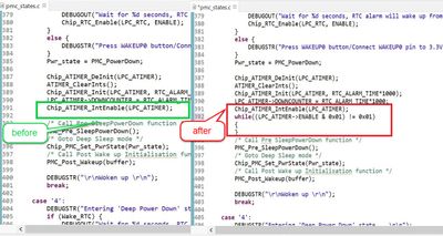

3.2  Alarm timer interrupt enable problem solution
To ensure that the Alarm timer interrupt is enabled, add a while loop poll after it until it is successfully enabled. Enter the function in the src\pmc_states.c path.
And add while((LPC_ATIMER->ENABLE& 0x01) != 0x01){}
after the Chip_ATIMER_IntEnable(LPC_ATIMER); function statement in the corresponding case mode.
3.3  Downcounter register write problem solution
The solution to this problem is similar to 3.2. Still enter the function with the src\pmc_states.c path, and find LPC_ATIMER->DOWNCOUNTER= RTC_ALARM_TIME*1000 in the case of the corresponding mode (consistent with the 3.2 position).
Add a while statement after it:
while(LPC_ATIMER->DOWNCOUNTER != RTC_ALARM_TIME*1000);
As shown below.

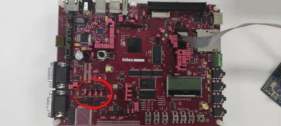

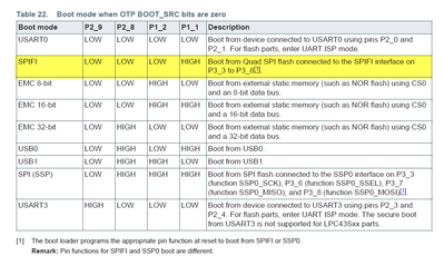

When there is no internal flash development board for testing (eg: LPC4370, LPC4350…), such as the Hitex LPC4350Evaluation board, it is necessary to configure the startup as external flash startup. The reference picture is as follows.
When starting, you need to set the pins P2_9, P2_8, P1_2, P1-1 to the form of low, low and high, and start in the form of SPIFI. Jumper settings are shown in the figure.
