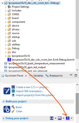

In some cases, this method forms well and is the easy way, open your IDE and select your project.
At this point you may have a debugger configuration of your last debug session, so, you have similar icons to the image.
Open the tab below and select erase.
Depending on your debugger configuration you need to select the same icons below.
Note: In some cases will be necessary to put your MCU in ISP.
And that’s all, could try if the MCU is out the brick mode.

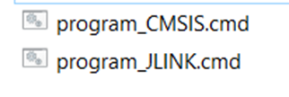

Once installed on the PC we need to locate these files of the installation.
Root example: C:\nxp\LPCScrypt\scripts

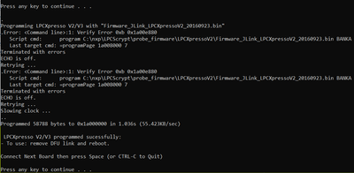

When you have the board on DFU, connecting the USB Llink2 to the PC and then RUN the Scrypt (program_JLINK) in CMD check Figure 3.
Press any key to continue…
Figure 3. Flash firmware of J-Link in DFU mode.
Successfully done, at this moment the EVK has the firmware of J-Link Segger. Review the Figure 4.
Figure 4. The firmware was flashed successfully.

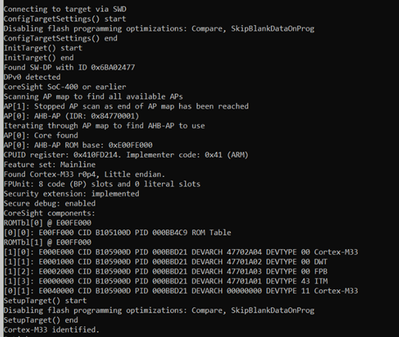

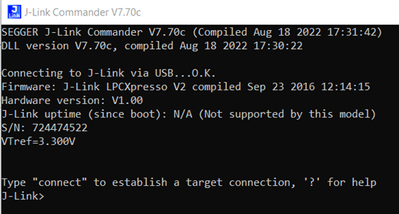

Open the software and if the communication is right the message will appear J-Link via USB… OK check Figure 6.
Figure 6. The EVK is now communicating to the tool J-Link Commander.
Commands
To start the communication needs to send the command “connect”.

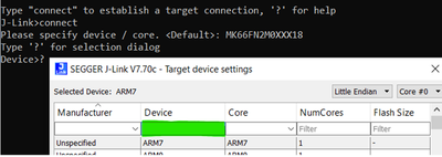

Then the tool shows your last target (if you use it) and use the next command “?” to change the target review Figure 7.
Figure 7. Review the target.
In the new popup window in the green area, you need to put the name of the target, take care you do not put the debugger check Figure 8.
Figure 8. In the green area, you need to put the matricula of the MCU target.
Example [LPC55s16 or LPC55s69] depending of your target check Figure 9.
Figure 9. If the tool supports the MCU will show below the red square.
In the next selections the tool is asking for the interface of communication, the communication of the EVK is SWD, and for that write “S” as SWD.
On speed, only click enter without entry. Then this will appear before the connection check Figure 10.
Figure 10. The communication is Done.

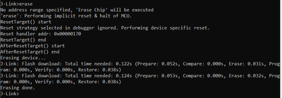

Then use the command “erase” like the Figure 11.
Figure 11. The tool indicate the erase is done.
Finally disconnect the USB and remove the ISP jumper, then open the IDE and test the blinky led example, or if you wanted you could use the BLHOST.

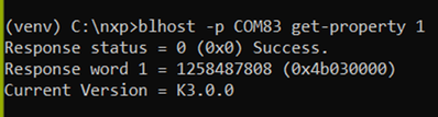

blhost -p COMxx  get-property 1
Figure 12. The first command is to check the communication.

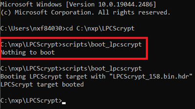

LPCScrypt
If the message appears “Nothing to boot”, need to be sure the board is connected to the PC with the DFU mode in LINK 2 check Figure 16.
Figure 16. The red square is an example of an error communication.

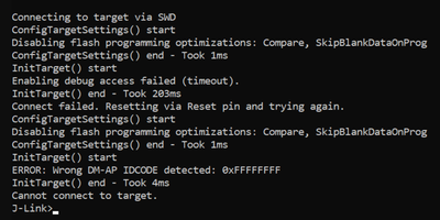

If a similar message appears, “Cannot connect to target”, need to put the target in ISP mode, and return to the first steps with J-Link commander check Figure 18.
Figure 18. Show how the communication is not done.
