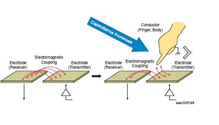

The Capacitive Touch module measures the change in capacitance of an electrode plate when an earth-ground connected object (for example, the finger or stylus) is brought within close proximity. Simply stated, the module delivers a small charge to an X capacitor (a mutual capacitance touch sensor), then transfers that charge to a larger Y capacitor (the measurement capacitor), and counts the number of iterations necessary for the voltage across the Y capacitor to cross a predetermined threshold.
Figure 1. Mutual Capacitive Touch
A pulse is applied between the transmitting and receiving electrode to generate an electromagnetic field. When a finger comes into close proximity, part of the electromagnetic field moves to the finger where the decrease in electromagnetic field strength is detected by the electrodes. The capacitance is detected and captured and recognized as a finger presence.

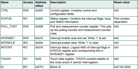

Registers
Programming of all these registers is performed only during initialization.
Table 1. Capacitive Touch Registers.

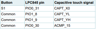

The connections for the capacitive touch button are shown in Table 2 below. If the Cap Touch button is not being used, the ports connected to it can be used for other purposes (such as GPIO), but note that PIO0_30 and PIO0_31 are effectively shorted together through resistor R19. If this zero ohm resistor may be removed if the Cap Touch button is not required.
Table 2. Capacitive touch button signals

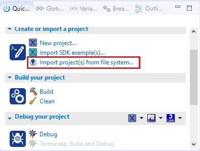

Once downloaded, we import the library project into the workspace using the ''Import project(s) from file system... from the Quickstart panel in MCUXpresso IDE:
Figure 2. Import Projects.

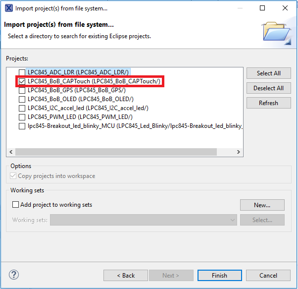

Press next, and see that are a selection of projects to import, in this case, only keep select the LPC845_BoB_CAPTouch how it looks in the picture below:
Figure 4. Select CapTouch Project

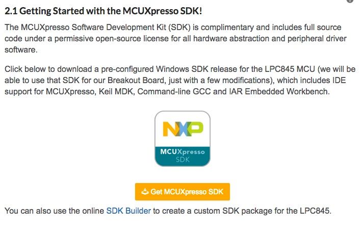

I'm wanting to get this board and use it alongside my LPCXpresso845MAX board, but an uncertain how to use the SDK. I saw the link above for the SDK_2.5.0_LPC845, but also saw on the LPC845-BRK Getting Started page (LPC845 Breakout Board for LPC84x family MCUs | NXP Screen show below.) that the SDK needs "just a few modifications." What exactly are those modifications?
Andre.
Hi Andre Lipinski,
You can use the SDK for the LPC845 MCU for this board without any changes, I refer to create a new project just to be sure to not select the MAX board when you created and select the corresponding MCU package of the Breakout board.
What means this part, is that you could port the SDK examples of the LPCxpresso845 MAX board to use it in the Breakout board, only with a few modifications, Those are very simple, you only have to switch the MCU package and route the correct pins, those are very simple with the config tools, you can refer to section 4 of the getting started to see a little more of this.
The example package that mentions in this post NXP example packages has a series of examples ready to use in the Breakout board without any modifications, you can also take a look of this, may be useful.
I hope that this help to answer your question, and if you have another not hesitate to ask.
