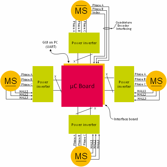

The brushless DC (BLDC) motor control design example describes how to connect and control up to four brushless DC motors using a single NXP microcontroller from the ARM968-based LPC2900 series, making this a low cost solution. Four dedicated motor control PWM blocks keep the CPU load low while running four motors. This allows the microcontroller to still perform other tasks in
Hardware used
  • Hitex LPC2939 or LPC2929 evaluation board
  • Hitex BLDC motor control extension board (4x)
  • Interface board
  • Maxon EC32 80W brushless servo motor with Quadrature Encoder Interface (QEI)
Three of the Hitex BLDC motor boards are driven as-is (spinning their on-board motors). The fourth board is driving the Maxon EC32 motor using the quadrature encoder interface. The interface board is used to create the correct pin-out that makes it possible to connect the four motor control extension boards to the LPC29xx evaluation board.
Block Diagram

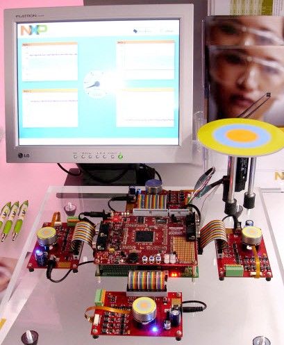

BLDC Motor Control Demo at ESC SV 2009
