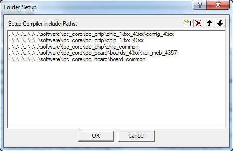

Include paths
Chip layer include paths
For a minimum project configuration, you will need the the chip driver header files, common chip layer header files, USBDROM header files, and the chip specific configuration file(s).

Board layer include paths
The board layer provides some abstracted functions for board setup, debug input/output, LED control, system startup code, and peripheral setup functions. The board layer isn't required to build and run LPCOpen code when used with the chip layer and other source code.
Board layer header files
The board layer header files include the common board API header file and the board.h file specific to the supported LPCOpen board you are using.
The board driver header files are in the "lpcopen/software/lpc_core/lpc_board/board_<CHIP>/<BOARD>" directory. Simply add the include path to these files to your project.

Typical include paths as part of a project for the Keil MCB4300 (LPC4357) board with the Keil Uvision toolchain
