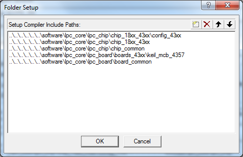

Include paths
Chip layer include paths
For a minimum project configuration, you will need the the chip driver header files, common chip layer header files, USBDROM header files, and the chip specific configuration file(s).
Chip layer header files
The chip driver header files include the individual driver header files and the chip.h file specific to the LPCOpen device family you are using.
The chip driver header files are in the "lpcopen/software/lpc_core/chip_<CHIP>" directory. Simply add the include path to these files to your project.
Example: For LPC8xx projects, you will need the "lpcopen/software/lpc_core/lpc_chip/chip_8xx" directory.
Common chip layer header files
The common chip layer files are common header files that are shared across multiple chip families. These include generic chip components such as common error code, ring buffer implementations, common type definitions, etc.
The common chip header files are in the "lpcopen/software/lpc_core/lpc_chip/chip_common" directory. Simply add the include path to these files to your project.
The USB device ROM library header files are included in a separate directory from chip files. These header files are only needed for projects that use the USB device ROM stack. Device family releases that do not have USB or USBD ROM support will not have these files.
The USBDROM header files are in the "lpcopen/software/lpc_core/lpc_chip/usbd_rom" directory. Simply add the include path to these files to your project.
Chip specific configuration file(s)
When the chip driver functions are being compiled, the specific target family device they will be built for must be defined to select the features for that device family. These include specific device family features, interrupt IRQ number and vector mapping, core revisions, etc. A single device family such as the LPC11xx may have multiple possible build time configurations that select the features for that device.
The device features are selected with the definition such as 'CHIP_LPC11XX'. These definitions are defined in configuration sub-directories inside the chip driver directory. One or more of these directories may exist for a specific device family and the path that matches the device the chip layer code will be built for must be included in the project, Only one configuration directory must be included, with the name of the directory indicating the supported device family.
Example: "lpcopen/software/lpc_core/lpc_chip/chip_11xx/config_11xxlv" must be added to the project when building the code for the LPC11XXLV device family.
Board layer include paths
The board layer provides some abstracted functions for board setup, debug input/output, LED control, system startup code, and peripheral setup functions. The board layer isn't required to build and run LPCOpen code when used with the chip layer and other source code.
Board layer header files
The board layer header files include the common board API header file and the board.h file specific to the supported LPCOpen board you are using.
The board driver header files are in the "lpcopen/software/lpc_core/lpc_board/board_<CHIP>/<BOARD>" directory. Simply add the include path to these files to your project.
Example: For the LPC1769 release, the supported board is the LPCXpresso LPC1769 board located in the "lpcopen/software/lpc_core/boards_8xx/nxp_xpresso_1769" directory.
Common board layer header files
The common board layer files are common header files that are shared across multiple platforms or boards. These include generic board components such as LED control, debug input/output, specific peripheral setup, etc.
The common board header files are in the "lpcopen/software/lpc_core/lpc_board/board_common" directory. Simply add the include path to these files to your project.
Typical include paths as part of a project for the Keil MCB4300 (LPC4357) board with the Keil Uvision toolchain
