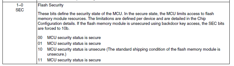

What is the difference between if security protect byte FSEC set to 0xFF & 0xFD ?
//FSEC          EQU     0xFE ; no security in flash
//FSEC          EQU     0xFF ; security protect
FSEC EQU 0xFD ; security protect
When I set FSEC to 0xFD , my program execution have something difference with 0xFE(No security)when FSEC setting to 0xFD, the program can't execute correct ? I am very confusing ?

Hi Tiger Lo
0xFF and 0xFD in FSEC field represent the same MCU secured state.
Hope this information could help you.
