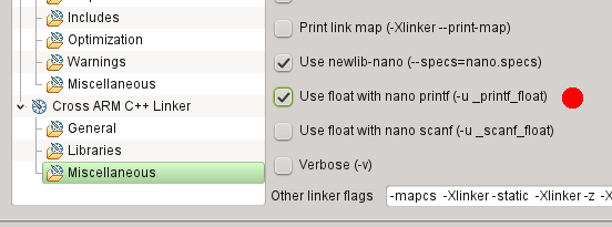

I am using Kinetis Design Studio 3.2.0 with SDK 2.0 for the K64F development board.
After browsing a lot of confusing and conflicting information and some testing, I found the following concerning printf() with float and double values.
sprintf() comes from the newlib-nano, and in order to  activate floating point I need to set the following linker flag as described in many places:

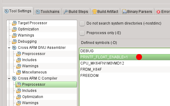

The very useful debug console also has a PRINTF function, that maps to DbgConsole_Printf, which is implemented separately and independently. In order to activate its floating point option, one needs to define PRINTF_FLOAT_ENABLE:
The test program included below furthermore revealed a bug in the PRINTF=DbgConsole_Printf implementation:
The bit pattern 0xffffffff interpreted as a 32-bit signed integer should print as "-1" but wrongly prints as "1" instead.
Hope this helps some others to save time,
G
