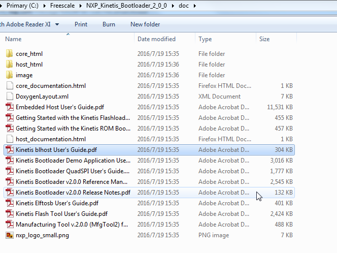

One of my customer is using KL82 and have some enquries on the Boot loader of KL82 .
Do we have utility tools (support Windows/Linux) for updating firmware through USB bootloader .??
1,213 Views
Kan_Li

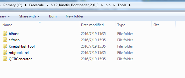

yes, we have such kind of tools available, after installing Kboot, you may find them in the following folder:
blhost supports linux , mac and windows, you may refer to the user guider in the doc folder for more details.
Kan
