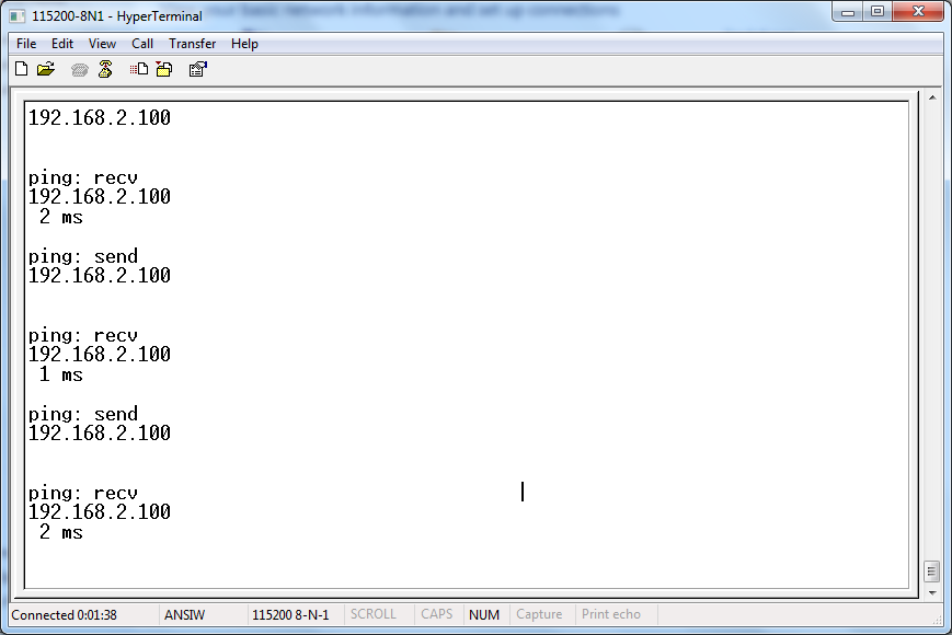

I was trying to build the demo of lwip stack with freertos. though I am able to build, debug and able to see debug prints like TCP/IP initializing/ initialized... and ping:send and ip address.
When I ping the board I am not able to get through it.
1. My activity is blinking(with equal interval) and link is steady. I have set the jumper settings in MII mode. I am able to see some debug printfs.
also i have tried,
2. My activity seems to blink (with unequal interval) and link is steady. I have set the jumper in RMII mode, I am unable to see any debug printfs.
I followed one of the guide for lwip stack integration for jumper settings. Is there any thing in details i need to check or missing here.

Which platform are you selecting to build that demo? Would you please help to specify? Thanks for your patience!
and the KSDK 1.2 has already provided the LwIP ping demo based on freeRTOS, you  may find in the folder of  C:\Freescale\KSDK_1.2.0\examples\frdmk64f\demo_apps\lwip\lwip_ping_demo\ping_rtos\ping_freertos after installation. Have you tried it? if you still fail with this demo, then maybe there is some hardware issue of your board, such as jumper settings or something like that, but if this demo works well with your board, there should  be software issue in your own project.

Oh I almost forgot mention about the hardware, I have currently chosen TWR-K64F120M based demo of LwIP and also working on a TWRK64 hardware. I have not changed any jumper settings expect I am putting the serv board in MII configuration. There is a document online which says hardware has to be configured in RMII mode for demo to work but the PHY driver code checks if its MII mode.
I am getting confused there. And can you direct me to the right jumper settings for achieving the LwIP demo?

Yes, TWR-K64F120M does support MII interface, but the LwIP ping demo needs some modification to support this . before going ahead, please check the board jumpers settings referring to the following links.
TWR-SER: http://cache.freescale.com/files/microcontrollers/doc/user_guide/TWRSERUM.pdf
TWR-K64F120M : http://cache.freescale.com/files/microcontrollers/doc/user_guide/TWRK64F120MUG.pdf
for TWR-K64F120M and TWR-SER, please make sure the jumpers are set in default configuration. Please note the K64 tower board user guide provide table 5 for RMII settings, so for MII, just following the table 6.
above are hardware configuration, for software , please open the project in the folder of "C:\Freescale\KSDK_1.2.0\examples\twrk64f120m\demo_apps\lwip\lwip_ping_demo\ping_bm" after you installed KSDK 1.2, and add MII config in ethernetif.c and use MII config to replace RMII config in the enet configuration structure.
enet_config_rmii_t miiCfg = {kEnetCfgMii, kEnetCfgSpeed100M, kEnetCfgFullDuplex, false, false};

I have tested that demo on my TWR-K64 board, and you may try it on your side.

Kan,
I just gave try and it works. thanks for the help.
