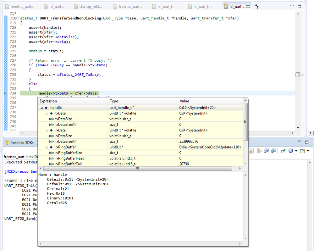

In fsl_uart_freertos.c, UART_RTOS_Send() calls UART_TransferSendNonBlocking().
The problem is that UART_RTOS_Send()'s 2nd parameters is not a uart_handle_t *.
This causes a fault when UART_TransferSendNonBlocking() attempts to deference the bad pointer.

Hi Bruce:
I debugged your code on my board. Please see below picture.
The parameters transfer is OK.
In your project, the variable "handle" address <0x15> is in flash, so it will result from a hardfault.
I increased the stack size , then it  can work on my side.
    xTaskCreate(uart_task, "Uart_task", configMINIMAL_STACK_SIZE + 200, NULL, uart_task_PRIORITY, NULL);

Yep, stack corruption.
I forget to increase the stack size.
Now to sort out why the UART RX is always giving me a kStatus_UART_RxHardwareOverrun in the UART callback.
