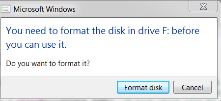

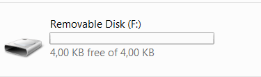

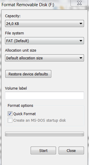

I've run with success frdmk64f_dev_msc_ramdisk_freertos example:
Next step, I want to write a text file into the ramdisk (from the code) to be read by the user on the host machine. How can I do that?
