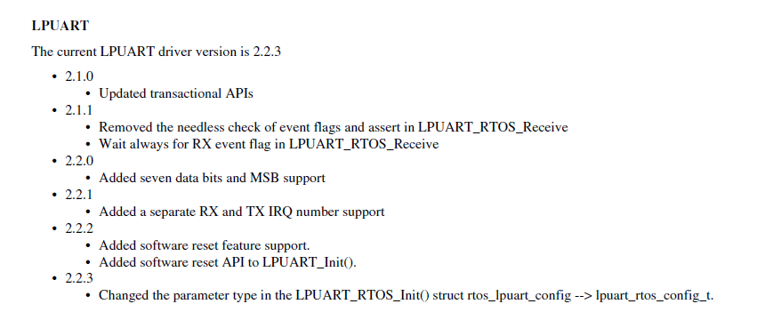

danielchen
Hi Maxime:
I would suggest you download the latest ksdk . From the release notes we can see that in LPUART driver, the needless check of event flags and assert in LPUART_RTOS_Receive was removed.
4,252 Views
mr_max
Ok thank you Daniel. Where can I find this update ? Do I need to build again SDK at https://kex.nxp.com ?
4,252 Views
danielchen
Yes.
