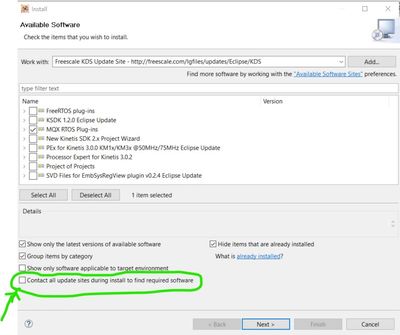

My update Eclipse still has problem as listed followed:
I have followed the instruction about remove the selection of contact all update sites …. But the problem was still existed. Is there anything that I can try?

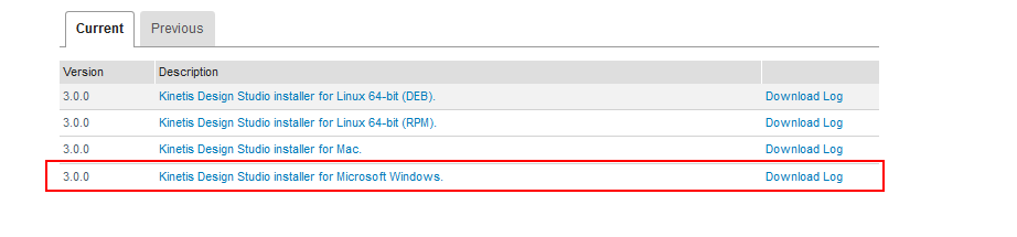

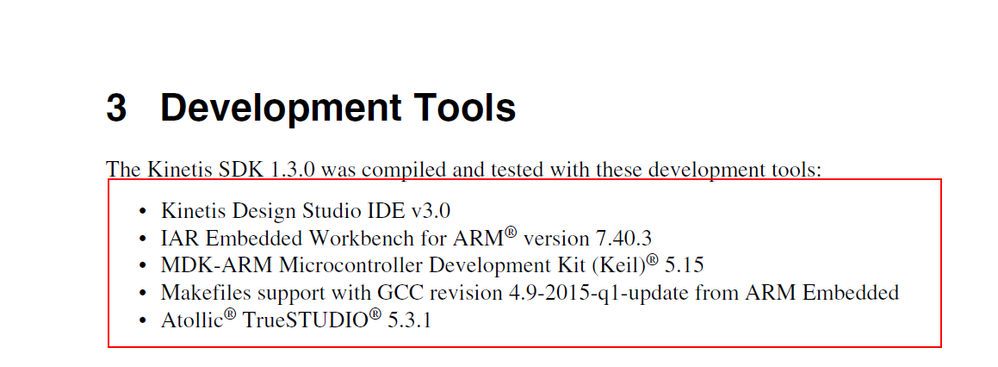

Hello Lin,
What about you SDK version , i recommend you install the latest one KSDK1.3 .
you can download here : Software Development Kit for Kinetis MCUs|Freescale
And what about your IDE KDS version ?  also recommend you use the latest version KDS3.0.
you can download here :Kinetis Design Studio Integrated Development |Freescale
For in the release note of KSDK1.3, we can see it support the KDS3.0 .

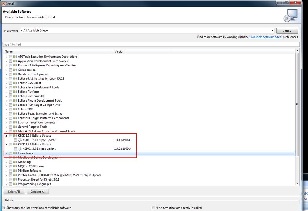

林偉川
All of your suggested version is what I installed. KDS is 3.0 and KSDK is 1.3.0. But the result is wrong as attached file. Is there any suggestion for me to try?

Hello ,
- I recommend you install the KDS at the default path ;
- If still can not work , please firstly install sdk 1.2 , then install sdk 1.3
- If it still not work , please screenshot the installation procedure step by step !!
only through the error can not fund the problem .
