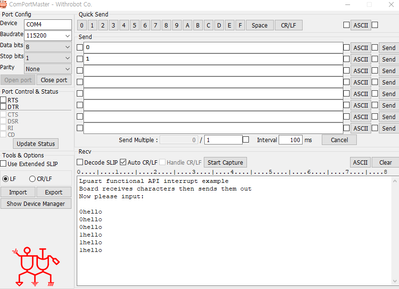

When I type "0", I print out hello I want to print out the world when I input "1".
2,991 Views
hyeonsunjang
I'd like to use this example to solve it.
This is an example of lpuart, and I want to solve it using interrupt method.
I am using keil uVisun5 program
I am using mpas-ks22.

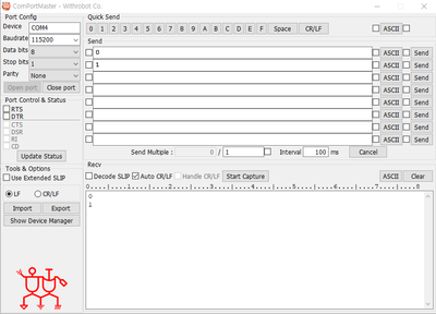

2,959 Views
hyeonsunjang
Thank you very much for your reply.
However,I tried as you taught me, but the code didn't work properly.
And I don't understand why "demoRingBuffer[0]" goes into if (demoRingBuffer[0]==0x30). I'd appreciate it if you let me know.
