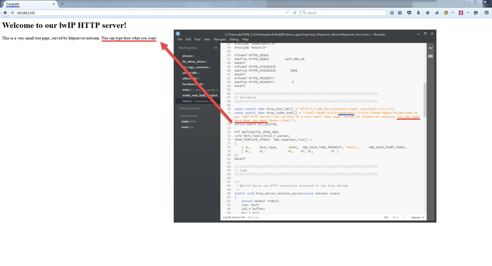

Estoy probando el ejemplo lwip_httpserver_demo_frdmk64f y funciona perfecto, la pregunta es: como puedo cambiar o modificar el contenido del index.html?

Hello Jorge Buxman,
the main page for HTTP Server Demo on lwIP TCP/IP Stack, you can modify here in main.c, inserting code to const static char http_index_html[].
You can find it here
C:\Freescale\KSDK_1.3.0\examples\frdmk64f\demo_apps\lwip\lwip_httpserver_demo\httpserver_rtos\main.c
const static char http_html_hdr[] = "HTTP/1.1 200 OK\r\nContent-type: text/html\r\n\r\n";
const static char http_index_html[] = "<html><head><title>Congrats!</title></head><body><h1>Welcome to our lwIP HTTP server!</h1><p>This is a very small test page, served by httpserver-netconn. You can type here what you want</body></html>";
I hope this helps.
