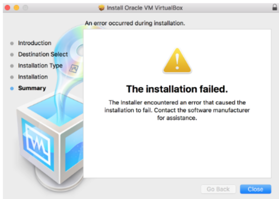

Hi, I am trying to install virtual box 6.0 in my MAC laptop.
I downloaded version 5.x and 6.x several versions. I got the same error, the installation failed.
Do you know how to solve this problems?

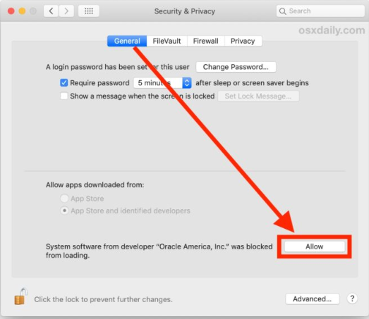

I would suggest you check the 'security & Privacy' and go to the 'General' tab within security preference panel.  At the bottom of the security  general section,  Allow the installation .
