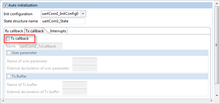

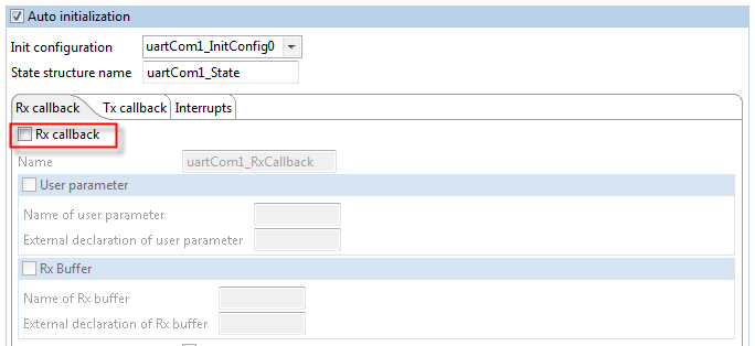

Doing my initial steps in KDS and Kinetis I faced a problem using “UART to console transaction” via OpenSDA USB link.
My project is implemented on FRDM-K64F using: KDS3.0, KSDK1.2+PE and UART based on fsl_uart component.
The program logic is based on a working “UART non-blocking driver” demo.
When I send predefined char string using “ UART_DRV_SendData(FSL_UARTCOM1, buffStart, byteCountBuff) ” method.
The result is that the first character of buffStart string is sent to console in endless loop.
I have same phenomena implementing  “DWF - Kinetis
Design Studio (KDS) using Processor Expert" - Lab4  ( https://community.freescale.com/docs/DOC-101650

Kan_Li
Hi Shaul,
I just reviewed your project, and found this issue is due to the RxCallback and TxCallback are enabled but left as undefined, disable them both can fix this issue.
Please kindly refer to Configuring MKL25 LPSCI with fsl_lpsci Processor Expert bean  for more details regarding RxCallback and TxCallback.
Hope that helps,
Kan
