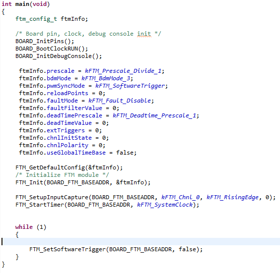

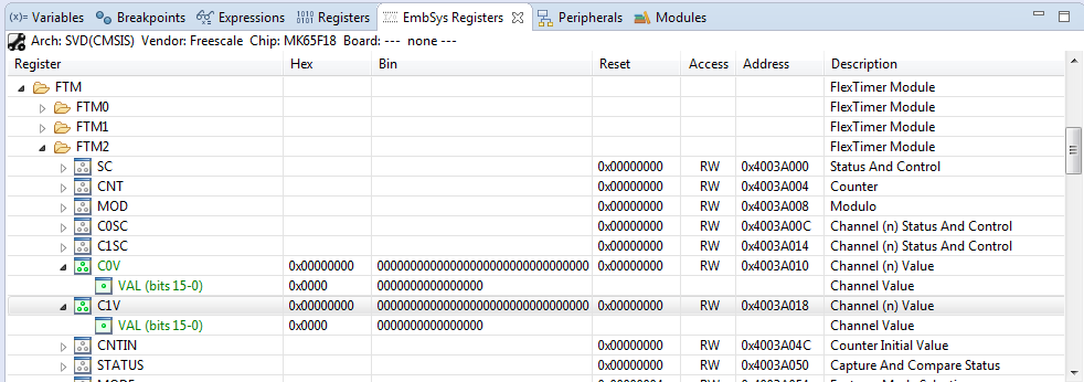

Hi Everyone,
Im new to using Kinetis microcontrollers and I have a TWR-K65F180M board that I'm trying to use to capture inputs from an encoder.  I am working off of the PWM_twochannel driver example using SDK2.0. I have the FTM set up to use FTM2_CH0.  The api document says that every time a rising edge is captured the counter value should be stored in the CnV register.  However, unable to read any values in the CnV registers using the EmbSysRegView.
Thanks for any help!
145529_145529.pngpastedImage_2.png145530_145530.pngpastedImage_3.png145531_145531.pngpastedImage_4.png

Sorry for late response. For input capture mode, you will need to set 0xFFFF to MOD register in order to use counter in free-running mode. Program should look like as follows:

If you try this code, you will be able to print on screen counter value.
I hope this can help you!
