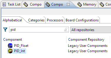

Where can I download the updated pid_in libraries?
How do I get the libraries that are stored in my components?
Because it redirects me to a page that tells me that I have to update the registry and it does not let me download KDS 3.0.0, FOR EXAMPLE
1,648 Views
BlackNight
I assume that you talk about this component?
Latest components are available on SourceForge, see McuOnEclipse Components: 26-Dec-2017 Release | MCU on Eclipse
The sources for the components are hosted on GitHub - ErichStyger/McuOnEclipse_PEx: McuOnEclipse Processor Expert Source Files and Components
If you are interested where the files are installed on your machine, see CDE Hacking: Where is my stuff? A dissection… | MCU on Eclipse
