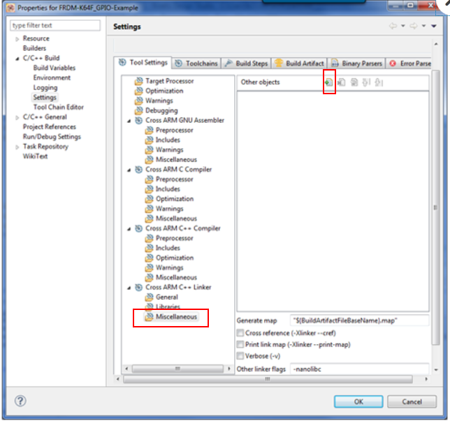

I am planning to write code in KDS that will use the I2C1 module on a FRDM-KL27Z board MCU and for this I want to make use of the HAL drivers provided, i.e.  fsl_i2c_hal.h
I am trying to call I2C_HAL_SetBaudRate() function and I get the undefined reference to 'I2C_HAL_SetBaudRate' although the fsl_i2c_hal.h file is included. To be noted that I can call any inline functions defined inside this header file, but no functions that are just declared inside the fsl_i2c_hal.h and defined inside fsl_i2c_hal.c. It seems that my compiler cannot find the latter file. How could I linked it to it? I presume that it has already been compiled somewhere before.
Any help??
1,516 Views
Hello Radu,
1) IF your project is KDS+sdk without PE , please first build the KSDK lib here :
Freescale\KSDK_1.3.0\lib\ksdk_platform_lib\kds\KL27Z644
then it will generate one ksdk_platform_lib.a under "lib\ksdk_platform_lib\kds\KL27Z644\debug"
add the .a file  in the compiler :
then you can use the functions under fsl_i2c_hal.h .  If it still can not work , please take a screenshot about the error and sen your project to me.
and tell me you use which version of KSDK.
2) If you create project with KSDK+PE, you can directly use the I2C_HAL_SetBaudRate function .
