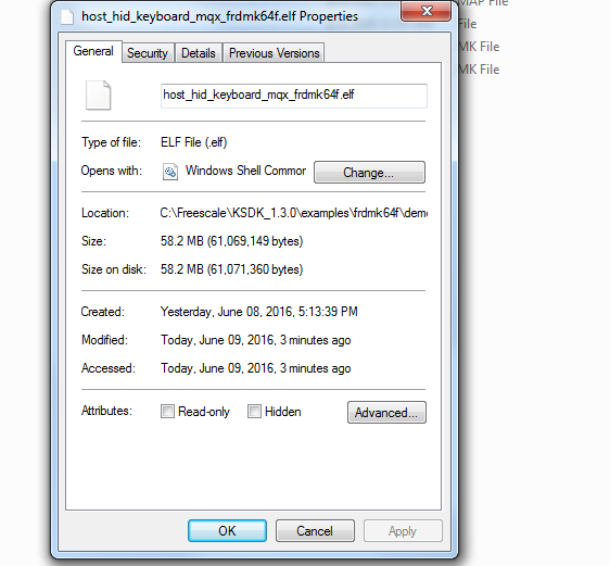

This means its 163436 bytes (163 KB), but when i go to the elf file it shows as below
Finally i found the answer in this link https://community.nxp.com/message/473587#comment-473587
I changed the output to Create Flash image and generated a .bin file. This is of correct size 108 KB.
I dont know why it shows the .elf size as 163KB but actually it is of huge size 59 MB. Whereas .bin and srec file is generated of correct size.

Unfortunately the size of this elf file is 58.2 MB (61,069,149 bytes).
The flash size of K64 FRDM is only 1 MB. How did it build this large size elf in debug mode ?
I cannot do drag and drop of this elf to my board because of this.
All my earlier apps which i built in the elf format (for debug) were around 500- 700 KB only (i.e. using bare metal or MQX with GCC_ARM).
Am i missing something ? How can this be corrected using KDS IDE as I plan to use KDS IDE in future also and don't plan to switch to command prompt build anymore.
