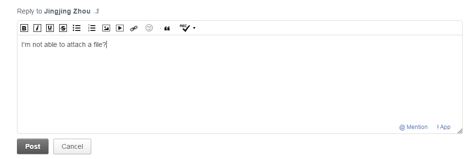

I'm not able to attach a file?
I can insert a picture. . .
. . .but I cannot attach a file.  I even tried drag/drop.
Am I missing something?  Is there another way I can send my project to you?

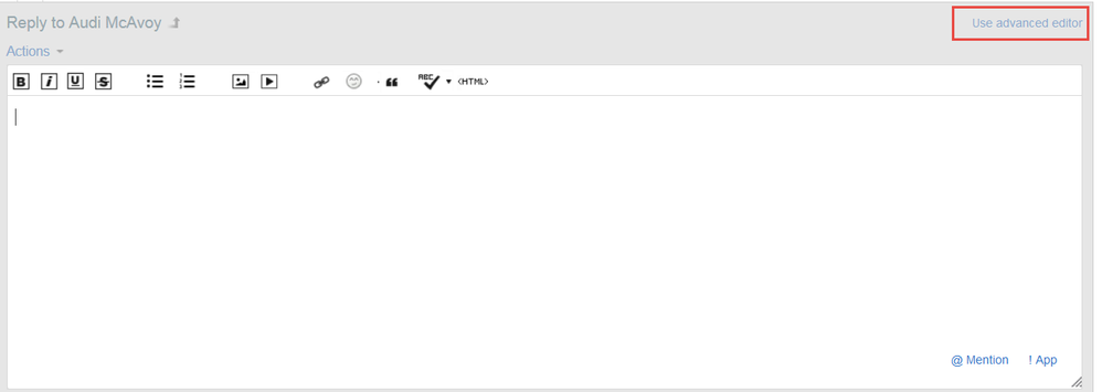

1, enter the advanced editor:
2, in the advanced interface, you will find the attach, then you can attach your project
5,428 Views
audi_mcavoy
I am starting to believe that you photoshopped your image just to tease me :smileyhappy:.  I honestly cannot find an option to enter the advanced editor mode.

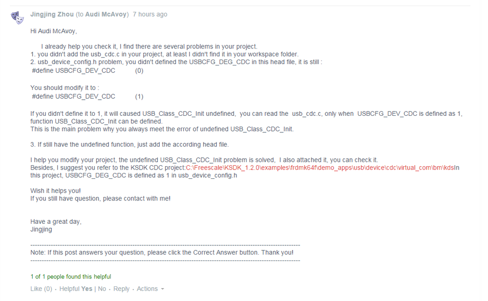

      I already help you check it, I find there are several problems in your project.
1. you didn't add the usb_cdc.c in your project, at least I didn't find it in your workspace folder.
2. usb_device_config.h problem, you didn't defined the USBCFG_DEG_CDC in this head file, it is still :
#define USBCFG_DEV_CDC          (0)
You should modify it to :
#define USBCFG_DEV_CDC          (1)
If you didn't define it to 1, it will caused USB_Class_CDC_Init undefined,  you can read the  usb_cdc.c, only when  USBCFG_DEV_CDC is defined as 1, function USB_Class_CDC_Init can be defined.
This is the main problem why you always meet the error of undefined USB_Class_CDC_Init.
3. If still have the undefined function, just add the according head file.
I help you modify your project, the undefined USB_Class_CDC_Init problem is solved,  I also attached it, you can check it.
Besides, I suggest you refer to the KSDK CDC project:C:\Freescale\KSDK_1.2.0\examples\frdmk64f\demo_apps\usb\device\cdc\virtual_com\bm\kdsIn this project, USBCFG_DEG_CDC is defined as 1 in usb_device_config.h
Wish it helps you!
If you still have question, please contact with me!
Jingjing
Ah, ha.  Since my usb_device_config.h was generated by PEx, I have a configuration problem.  I will work on that first.  Then I will work on the dependencies problem.
Thank you very much for your help.
