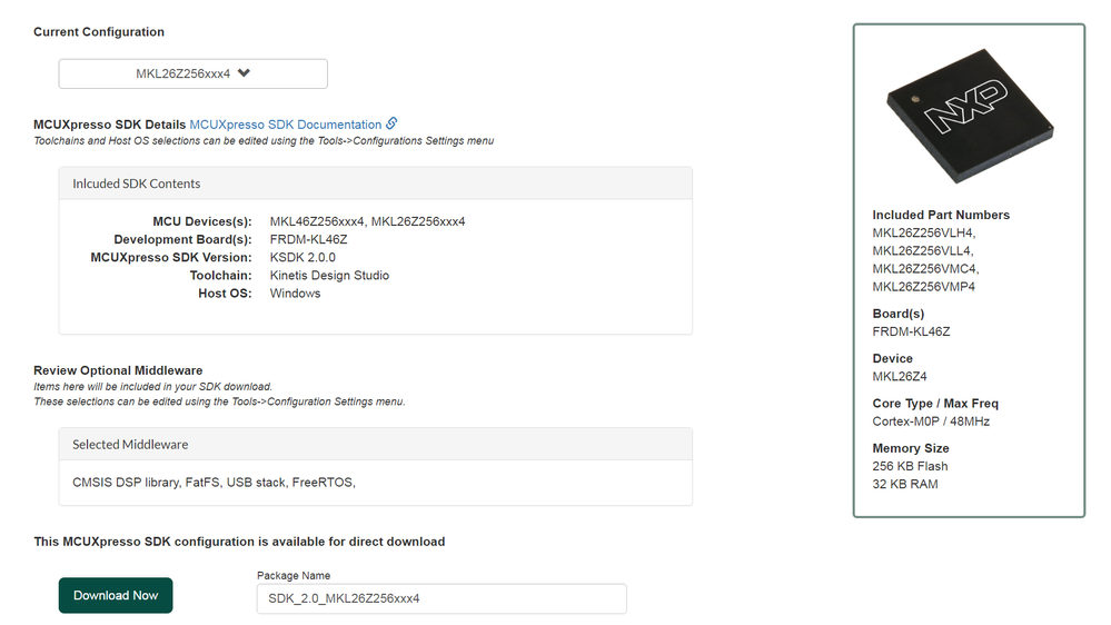

I found there are no "lpuart" drivers in the driver directory of my project (fsl_xxx.c, fsl_xxx.h). There are fsl_uart.c and fsl_uart.h as far as uart-related names. Is it possible that I don't have the right SDK ?
I'm pretty sure I downloaded SDK2.0 with the configuration set for the microcontroller MKL26Z256xxx as follows:
I followed this link to downloaded and configured my SDK:
Software Development Kit for Kinetis MCUs|NXP
and downloaded the 2nd item (Kinetis SDK Builder REV 2 & 1.3) in the Software Development Kit section.
If this is not the right one or there is something wrong in my setup, can you help me to correct it?
Thanks so much.
--Daniel

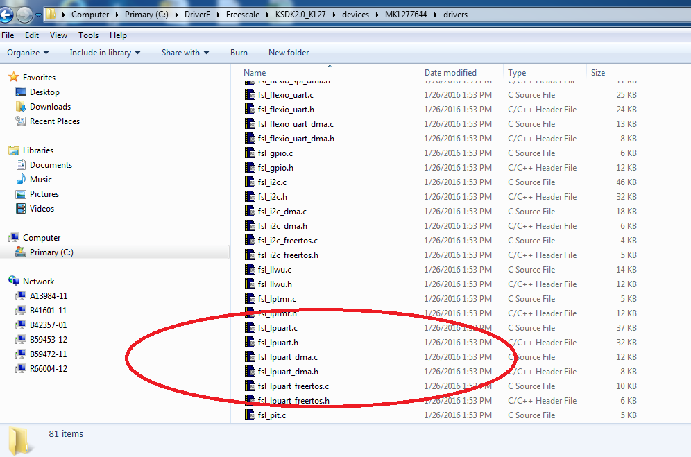

I attach the SDK driver for KL27, you can see the fsl_lpuart.c, hope it can help you
XiangJun Rong
2,056 Views
danieltruong
Hi Xiangjun,
The KL27 may have the "lpuart" function, but it's not the same name in KL26. In KL26 family, it's named "lpsci".
