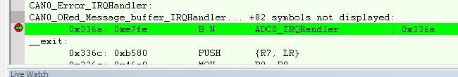

tim
Hi David,
I am using a timeout of 1.  Here is the call:
     UART_DRV_ReceiveDataBlocking(BOARD_DEBUG_UART_INSTANCE, &ch, 1, 1);
IAR EW allows me to step into this function and I can see data in UART0_D but it doesn't get returned.  When I take out breakpoints and let it run free through these functions, it won't return.  When I stop it, I end up here:
When stepping through it, I can't see anything wrong, except for the lack of the return.
Tim

DavidS
Hi Tim,
I am looking at the IAR hello_world in KSDK1.0.0 and see the same issue.
I am looking at the KDS hello_world in KSDK1.0.0. and see the same issue.
If I use File->New->Kinetis Design Studio Project and use PE, I am not having the issue.
In short the LPTMR appears to not be setup which causes issue when configuring the timeout to anything but "OSA_WAIT_FOREVER".
I will continue to look to find the switch to turn on the LPTMR and get back to you.

DavidS
Hi Tim,
My assumption was correct.  The hello_world project in KSDK1.0.0 did not have the LPTMR enabled so any value other than OSA_WAIT_FOREVER for timeout cause issue.
Attached is my modified hello_world.c program.  I basically grabbed code from the lptmr_demo and set LPTIMER up into non-interrupt mode so it run as a free counting timer and now works when a timeout value is used.
