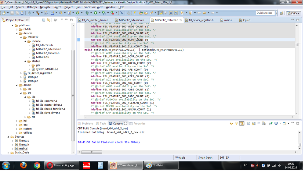

Hello, community!
I have a trouble with create new project in Kinetis Design Studio 3. I build a SDK1.3 in Kinetis expert for my FRDM-K64f board, unpack it and make a Eclipse update in KDS. Installed Processor Expert for Kinetis 3.0.2. I build ksdk_platform_lib and ksdk_ hal_lib. then i create new project with a wizard:
1) select "Kinetis SDK 1.x or Processor expert Project"
2) input project name
3) select device. I try to make a different projects for "board" and "Processor"
4) I select a Kinetis SDK (SDK1.3 for FRDM-K64F and check SDK path; i choose "Processor expert"; I try to make a different projects for "linked" and "standalone"; create a project.
5) then i added a processor expert component, for example, I2C (fsl_I2C from KSDK1.3.0 repositories.
6) generate a processor expert code and build project and...

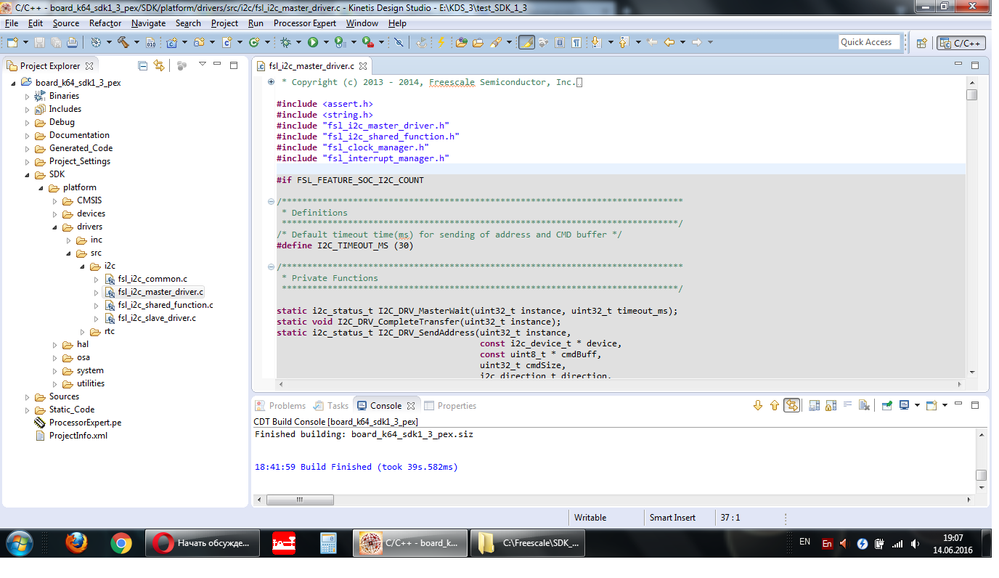

7) my project not work. when I look into driver's source file ( /SDK/platform/drivers/src/i2c/fsl_i2c_master_driver.c) i see, what all the driver functions is not active, because "FSL_FEATURE_SOC_I2C_COUNT" is "false"
8) i try to add another components but get same result...
"FSL_FEATURE_SOC_I2C_COUNT" and other peripheria defined in file "MK64F12_features.h" which called from "fsl_device_registers.h" which called from "Cpu.h" which include in main.c
I really don't understanding, why "feature defines" (active for my CPU in "MK64F12_features.h") not work.
Hope for HELP!!!
Regards, Oleg

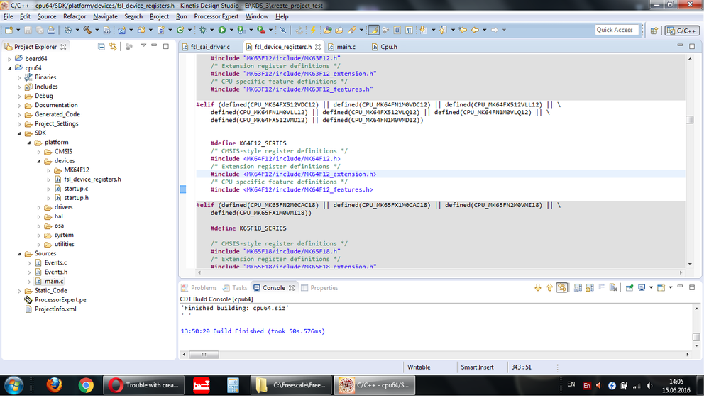

oleglavrukhin
I continued my experiments. I re-install KDS 3.2 and SDK1.3, create new project for FRDM-K64f board (SDK + processor expert) and... all the peripheral driver's functions is not active in driver file.
I install KDS 3.0 and SDK 1.3, create a project and get same result.
I think, this bug in SDK package.
I resolved this issue - in "fsl_device_registers.h" (/SDK/platform/device folder) in define block for my CPU, change a way for MK64F12 header files: #include "MK64F12/include/MK64F12_features.h" to #include <MK64F12/include/MK64F12_features.h>
then rebuild a project and all peripheral driver's functions is ACTIVE!!!
I hope this help somebody and I want  get a answer from SDK team about this issue.
Good luck
Oleg

BlackNight
Hi Oleg,
I'm not sure if I can follow and see your problem. But if it is about what is grayed out and what is not grayed out in the Eclipse editor view: It could be related to use 'heuristics' in Eclipse. This controls how the 'index' is built which is responsible to gray out or show symbols in the Editor view.
If this is indeed the problem you describe, then have a look here: https://mcuoneclipse.com/2012/03/20/fixing-the-eclipse-index/
Basically you should set the workspace settings to disable heuristics and rebuild the Index.
I hope this helps,
Erich
3,936 Views
oleglavrukhin
Thanks, Erich! I change KDS setting and all OK!
