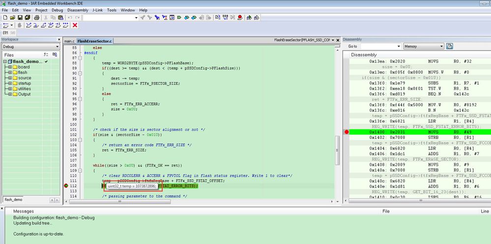

     Actually, if you have the IAR IDE, you can use this IDE, when do step debug in the  FlashEraseSector function, it can view the local variable:
  Besides, this IDE don't have the strange sequence and skips.
You can test this project on your side: C:\Freescale\KSDK_1.3.0\examples\frdmk22f\demo_apps\flash_demo\iar

We saw that demo project also runs ramdomly through the lines. So, that is not a bad signal.
But, we still don't understand what is causing the error.

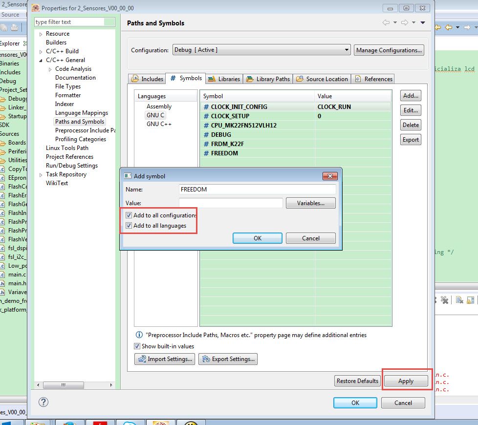

The warning you see there refers to a folder that physically doesn't exist in his project. So, we just removed its path from ARM C Compiler Includes in Project Properties. The startup files are already present in another folder (Project Settings / Startup Code). We really don't know how that path came up.
After recompiling the project, some irrelevant warnings came up, but nothing that I believe we have to worry about:
But we are still facing the same error and so far we don't have a clue on what is causing it. Could you please make the changes as described above? Probably you will be able to reproduce the same error (0x20) from "Erase Sector" function on your side.

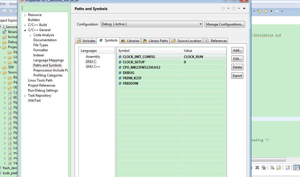

I'm glad to tell you that after your last tips, "Erase Sector" function is working fine now. Thank you very much! But I need to ask you: Shouldn't those tips be present in "KSDK API Reference Manual" or in another KSDK manual? We really haven't found any document from Freescale mentioning this...
Two points that call our attention:

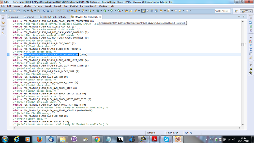

Acording to K22 reference manual, its Flash have 4K sectors. But Flash sector size is defined in "MK22F51212_features.h" and its value is 2048. Why?
The other point is that "CLOCK_SETUP" symbol with value 0 is not defined in Properties of "flash_demo_frdmk22f" project. Could you explain us why?

1.  I don't know which K22 reference manual you are refering, because you tell me your chip is MK22FN512VLH12, then you need to refer K22P121M120SF7RM.pdf.
Page 628, you will find that the sector size is 2KB, not 4KB, so the data is 2048.

I got a little confused. I had refered to MK22FN1M0 and MK22FX512 reference manual, where I saw that Flash sector size is 4K. When I checked MK22FN512 reference manual, I found that, for this MCU, Flash sector size is 2K. So, there are no errors in KSDK FRDM-K22F Flash demo. I was wrong!
That makes sense, because MK22FX512 has a bigger Flash memory, since part of it is Flex Memory, and thus, has bigger sectors like MK22FN1M0, as well.

  1: Debug in step run s ramdomly
    I think this is the KDS debug bug, I already report this problem to the KDS department, they will help to solve this KDS problem.
  2: variable output "optimized out"
    KDS engineer think this is not the bug, you can add volatile before the variable defination to solve it, eg, define temp1 as: volatile uint32_t temp1;
  3: flash sector erase error: 0x20 in FTFA_FSTAT
  I check your code, and test it carefully, at last I find it caused by the KDS option define problem, you need to delete all your old define symbol, and add it again, please configure it like this:
After the new configuration, then build it again, you will find your flash sector erase is ok.
You problem is caused by the define is invalid, then your flash clock will not correct, it will cause the flash operation error.

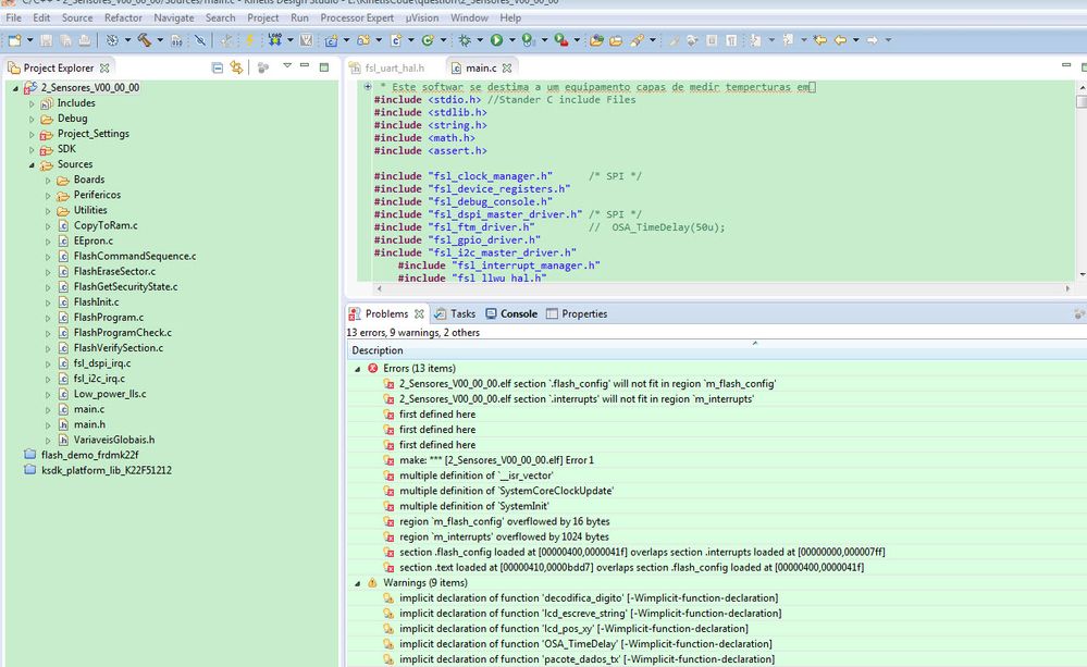

      But I still can't run your project on my side, it has a lot of complie problems, I already complie my KSDK libray.

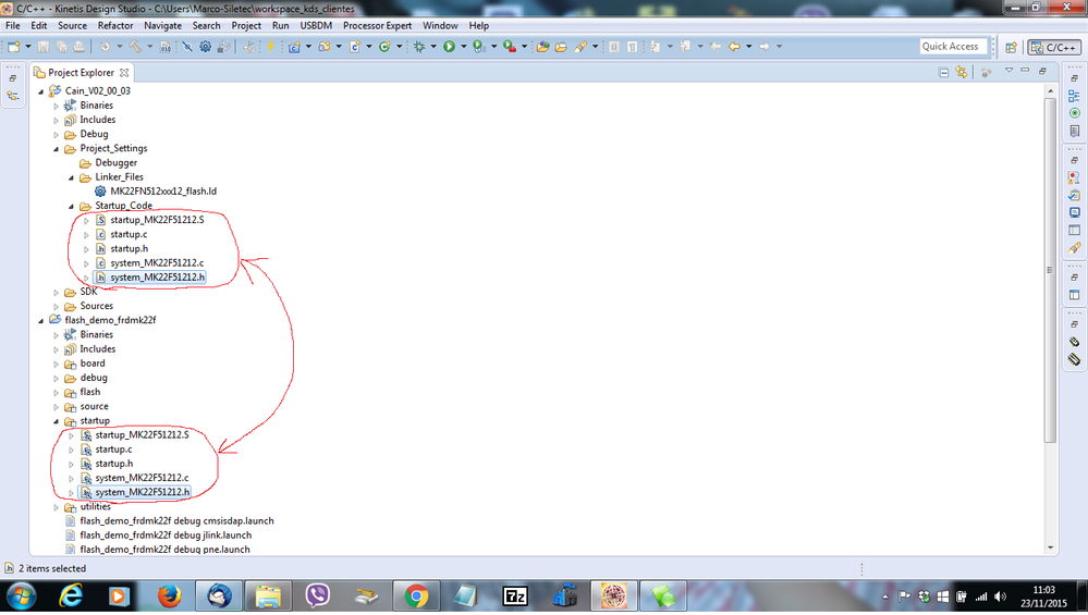

    1: it has this warning:
Description Resource Path Location Type
Invalid project path: Include path not found (E:\KinetisCode\question\2_Sensores_V00_00_00\2_Sensores_V00_00_00\SDK\platform\devices\MK22F51212\startup). 2_Sensores_V00_00_00  pathentry Path Entry Problem
  I check your code path:2_Sensores_V00_00_00\SDK\platform\devices\MK22F51212, there has no startup folder,
  2: then I copy :C:\Freescale\KSDK_1.3.0\platform\devices\MK22F51212\startup
to your project folder, but there has a lot of errors, just like the following picture:
So, I think maybe you can check your project in another computer again.
