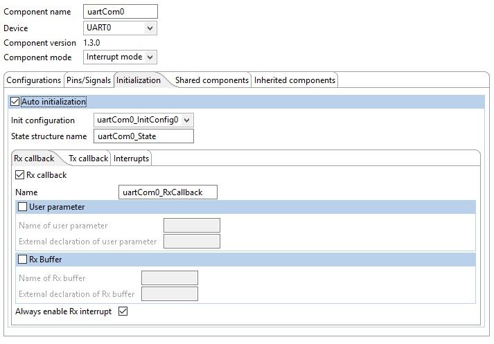

I am working on a very simple project that interacts with a UART port using interrupts. My plan is to use the Peripheral Driver, "fsl_uart", and the RX/TX callback routines.
At one point, I thought I got it to enter UART_DRV_IRQHandler but haven't been able to get it to work again. Either way, it never got to uartCom0_RxCallback when I entered a keystroke on the UART port. I have been able to get the UART_DRV_SendData and UART_DRV_ReceiveData in a polling kind of mode. My preference, at least on the receive side, is to always use the interrupt routine to process these inputs from the UART port.
Any ideas what is going on?
Thanks.
Phil

Hello Phil.
There i a bug on the function of "UART_DRV_IRQHandler" , please add the two line to the
receive interrupt and send interrupt :
you can also refer to here :
The usage of UART callback function install
After fixed here , if your project still can not work well , please send you project to me .

philhale
Alice,
Thank you. I was not successful until I added a RX buffer. The modifications you suggested were required. Nothing worked without these changes so I thank you.
Thank you!
Phil
