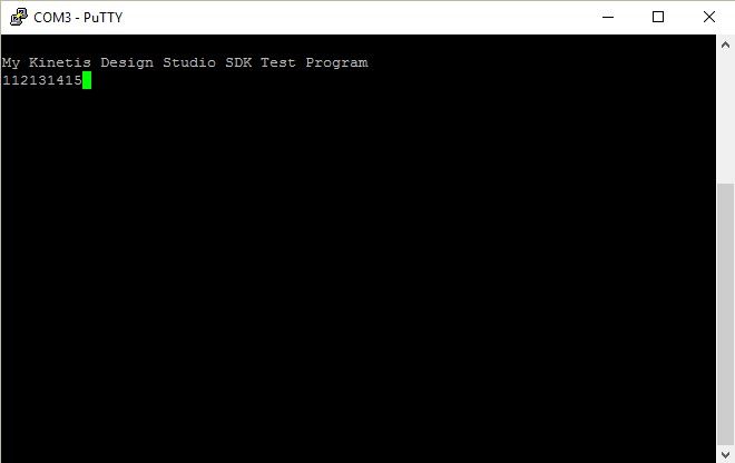

philhale
Kyi Zaw Win,
We are close. I tried what you suggested but I got a slightly different result.
Here is what I see when I type "12345" into PuTTY:
It is like the first byte is kept in the buffer.

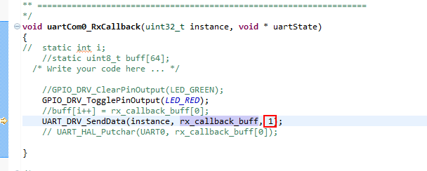

Hello ,
Please change the code here :
then it will work well .
Alice Yang

philhale
Sorry. Didn't work.
Typing an "a" returns an "a". Next, typing a "b" returns an "a". Next typing a "c" returns an "a".
The buffer is not getting cleared. If the buffer was getting cleared then your change would certainly work. Where and when is this buffer cleared?

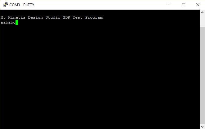

philhale
Alice,
I am using my own board utilizing the MK64FX512VLL12. In my code, I am utilizing the RxCallback interrupt routine to receive the incoming data from the UART. This allows me to accept UART data from an outside source (RS232 in my case) through non-polling methods. The routine works and I receive data in my rx buffer but after processing the data I do not know how to clear the buffer.
Here is what displays on my RS232 screen when I type "abc":
Thanks.
