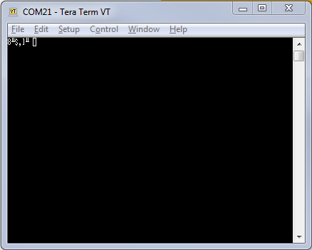

I'm using the USB CDC VCOM code found in KSDK 1.3.0 and I'm attempting to write a string to my terminal.  The call is simple:
USB_Class_CDC_Send_Data(applicationHandle, DIC_BULK_IN_ENDPOINT, "Hello, World!", 13);
I've also tried casting (uint8_t*)"Hello, World!".  Both methods print some non ASCII characters:
So I played around with it and did this:
    uint8_t *buffer;
    buffer = malloc(size);
    memcpy(buffer, "Hello, World!", 13);
     USB_Class_CDC_Send_Data(applicationHandle, DIC_BULK_IN_ENDPOINT, buffer, 13);
and it prints:
I don't believe I should have to copy the buffer in order to print the message, so what am I doing wrong; or what is the SDK doing that's preventing me from simply printing out a specified byte sequence.

Hi Kevin,
I apologize for the late response.
This behaviour is expected and is correct.
If you refer to structure of the function, there is expected pointer on buffer.
uint8_t* app_buff,
usb_status USB_Class_CDC_Send_Data
cdc_handle_t cdc_handle,
uint8_t ep_num,
uint8_t* app_buff,
uint32_t size
Because - if you hand over text parameter (instead of pointer on buffer), there will be displayed content which is on this address in hexa.
I hope this explains your question.
