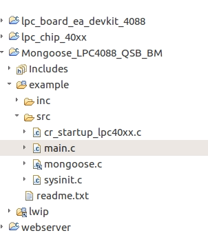

i am not working on an LPC4088 port and found that to be much better: in the LPCOpen package drivers are themselves separate Eclipse projects, and other projects can refer to them using eclipse path variables, like so: ${workspace_loc:/lpc_chip_40xx/inc}
lpc_chip_40xx here is the driver project's name, so it doesn't matter where the user put SDK, i can simply instruct them to import this particular project and that's it. very handy.

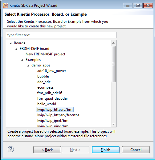

MarekTrmac
Hi Deomid,
it is possible to clone SDK example projects using File - New - Kinetis SDK 2.x Project wizard, see attached picture.
With this selection, the wizard copies selected SDK example into your workspace and it contains only sources needed in thes example and no other sources are needed.
Please mind, the cloning functionality is not available for all SDK packages, because there is needed specific information for each example project to be able to clone it. Ensure you have New Project Wizard for SDK 2.x updated from the update site and download the latest SDK package from the kex.nxp.com.
The same functionality is available in Project Generator if you select to Clone with Stand Alone option.
Marek

rojer
Marek, this is the opposite of what i want, though.
the last thing i want it to make a copy of all the drivers and lwip yet again for my project.
if a new sdk is released, fixing some bugs (e.g. the ethernet rx bug reported earlier) or adding improvements, my project will also need to be updated and re-released.
instead, it's much better if i just say - take the latest SDK from NXP and import the "K6x_drivers", "K6FRDM_drivers", "K6x_LWIP" from it, or some such. i don't have to carry a whole bunch of unrelated files along with my stuff and keep them in sync with SDK releases.
Here's project tree of the same example for LPC. I want _that_ :smileyhappy: (except they don't have a project for LWIP, so i have to sneak it from the SDK webserver example).

MarekTrmac
Hi Deomid,
So you can use SDK Project Generator to clone the project. Do not select "Stand Alone" option to create linked project.
Marek
