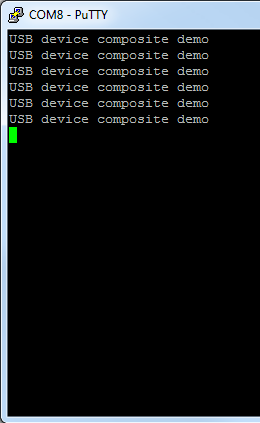

mwais
Hi Kan,
Generated project using Kinetis Expert for windows: see vault below:
Unzipped SDK 2.0  to this folder: C:\Freescale\SDK_2.0_MKL43Z256xxx4
Using FRDM-KL43Z board.  Imported project: dev_composite_hid_mouse_hid_keyboard_bm_frdmkl43z
located at:
C:\Freescale\SDK_2.0_MKL43Z256xxx4\boards\frdmkl43z\usb_examples\usb_device_composite_hid_mouse_hid_keyboard
Added your code above to hid_keyboard.c:
usb_status_t USB_DeviceHidKeyboardCallback(class_handle_t handle, uint32_t event, void *param)
        case kUSB_DeviceHidEventSetReport:
        if (s_UsbDeviceComposite->attach)
            uint32_t index = 0;
            uint8_t *buff = NULL;
            g_output_report = (usb_device_hid_report_struct_t *)param;
            buff = g_output_report->reportBuffer;
            printf("kUSB_DeviceHidEventSetReport!\r\n");
            printf("Report ID: %d\r\n", g_output_report->reportId);
            printf("Report Type: %d\r\n", g_output_report->reportType);
            printf("Printing %d received data:\r\n", (uint8_t)g_output_report->reportLength);
            for (index = 0; index < g_output_report->reportLength; index++)
                printf(" 0x%X ", buff[index]);
            printf("\r\n");
            error = kStatus_USB_Success;
        break;
        case kUSB_DeviceHidEventRequestReportBuffer:
            if (g_output_report->reportLength <= sizeof(s_UsbDeviceHidReportBuffer))
                g_output_report->reportBuffer = &s_UsbDeviceHidReportBuffer[0];
            else
                error = kStatus_USB_InvalidRequest;
Pressed "caps lock key" several times and did not see the buffer printed to the terminal :
Matt
