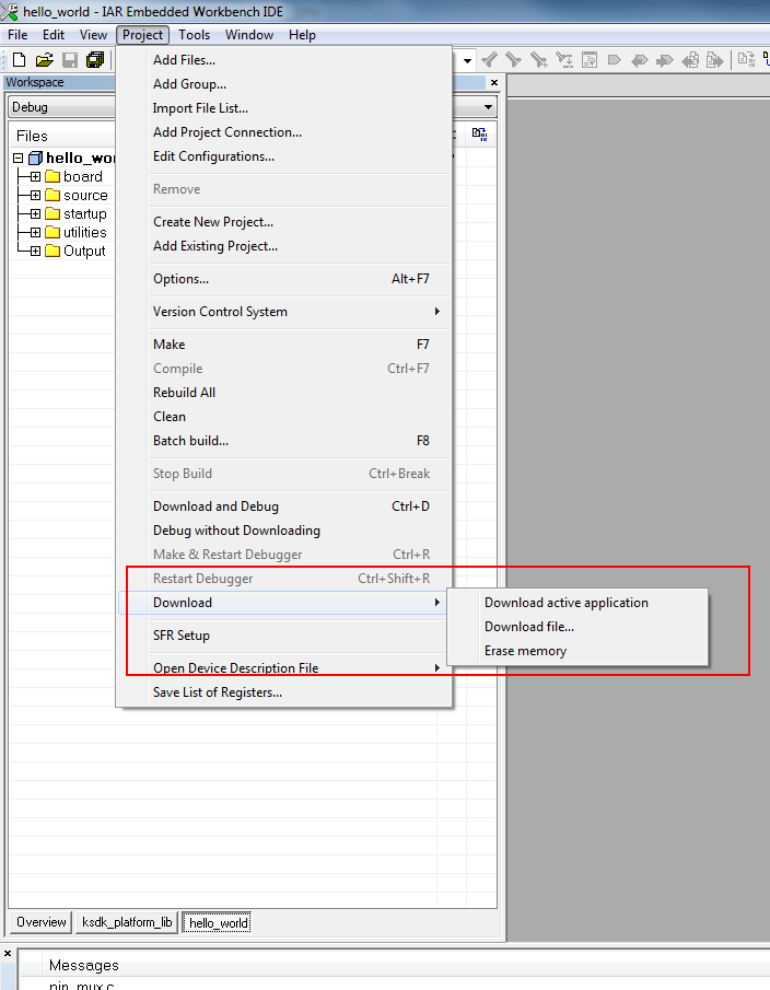

Does SDK_1.3_FRDM-KL03Z support debug?
I down load SDK_1.3_FRDM-KL03Z and build successfully. i try to do online debug. but "download" menu is disabled?

Hi ZY,
The "Hello world " is a simple project , if you do not want to use KSDK, you can
delete the more codes about KSDK .
And you can also  create one new project refer to the EW_GettingStarted.ENU.pdf  for the part
"Creating an application project " .
Hope it helps
Alice

Hi Alice,
For the project in “SDK_1.3_FRDM-KL03Z” doesn`t support debug. I just want an blank project base on “MKL03Z32VFG4” to verify debug function.

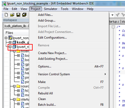

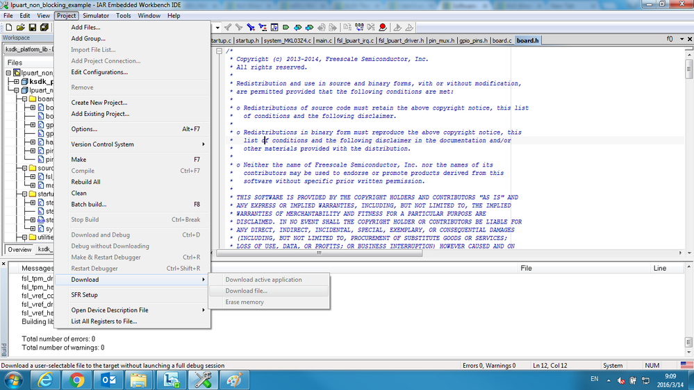

Oh Zhiyu,
The KSDK1.3_lib doesn't support debug , for your project, please click the proejct of "lpuart_...",
then debug it .
If still can not, please take a screenshot step by step about how did you operate , and
show me you have select the project you want to debug , not the lib .
Alice

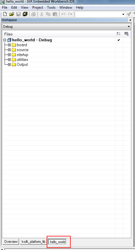

Hello Zhiyu,
please select the project , not the KSDK lib , then download , it can work well :
Hope it helps
Alice Yang
