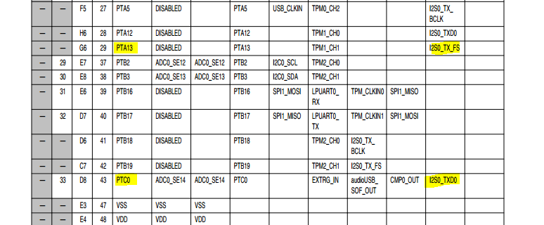

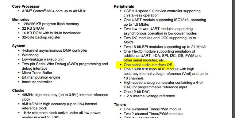

andrewdeliso
Hi Xiangjun Rong,
On Rev. 5 of the datasheet:
And in 01/2016 version of the reference manual:
4,499 Views
xiangjunrong
Hi, Andrew,
I apologize for the wrong information, the Kl27Z does have SAI module. I have downloaded the latest revision 5 of Reference manual of KL27, it says that Kl27 has SAI module exactly. But the revision 3 of reference manual of Kl27 I had does not mention any SAI module. I suspect that is why the software  team does not develop code for the SAI module.
Regarding the driver of SAI, I think you can download the SAI driver from the other chip for example Kl33/kl36, and copy the fsl_sai.c and fsl_sai.h code to the C:\Freescale\KSDK2.0_KL27\devices\MKL27Z644\drivers, it is okay.

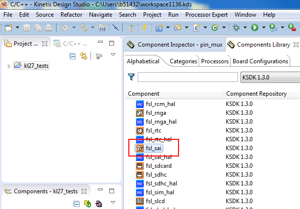

Hello Andrew,
If the ksdk2.0 have not the SAI driver, you can use the KSDK1.3,
it have "fsl_sai"
pastedImage_0.pngf
Hope it helps
Alice

andrewdeliso
Hi Alice,
I looked at the v1.3 SDK.  Is there a plan to port this driver to 2.0?  Also the 1.3 SDK has a feature count of 0, has this driver been tested on this platform?
./platform/devices/MKL27Z644/include/MKL27Z644_features.h:224:#define FSL_FEATURE_SOC_I2S_COUNT (0)
