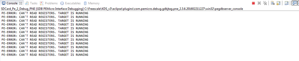

garimaparashar
Hi Erich,
Thanks for quick reply.
I tried this already to put break point inside f_open, so that I can be specific @ problem, but unable to go inside the f_open()
Sometimes program jumps to boot.s file and sometimes it jumps on 0x410.h file indicate no source available for 0x410 error. And in console window i can see the following printing continuously
I also see the Debugger disconnects after code download  that suggest to disable all the break points. But if I disable the break points then how would I come to know that f_open() working successfully or not?
One more thing I can use printf as debugger but, I dont know why changing  from MQX_Lite->MQX Std,  printf stops working, Strange....!!!!   For this I read sdk_standard mqx +PE -- printf -kds3.0  but my fsl_debug_console component is already disabled. I read this too https://community.nxp.com/thread/377533  but unable to get the solution.

BlackNight
Hi Garima,
the thing about breakpoints is only about 'non-existing' locations. Have a read at Failed to Debug with GDB: Breakpoints or Expressions on non-existing Locations | MCU on Eclipse .
So it is only a GDB problem if you have such a breakpoint, but you still can debug in a normal way.
