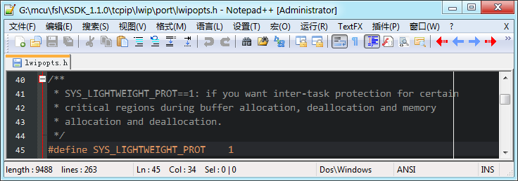

Hi Vincent
You just need set SYS_LIGHTWEIGHT_PROT to 1 on lwipopts.h.
Since our customer had encountered a similar problem with you, and I solve it with this.
After doing this, lwip@KSDK bacame a strong stack that can hold on UDP flood attack instead of went to HARD fault.
