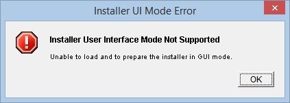

In my chores to upgrade the tool set for Kinetis development I installed KSDK 1.2.0, migrated my important projects and went to the install of KSDK 1.0.0.
However, I got the following message from the uninstaller (first called from the Windows panel, then directly from the folder where it is intalled):
My platform is Windows 64 bit version 8.1.
The Java version is 1.70_25:
Java(TM) SE Runtime Environment (build 1.7.0_25-b17)
Java HotSpot(TM) 64-Bit Server VM (build 23.25-b01, mixed mode)
How can I manage to have this uninstall to work?

Hello Cesar Rabak,

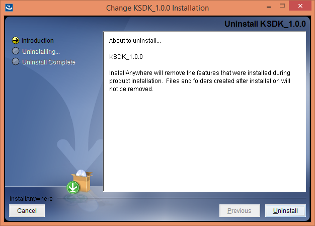

I tested on my side, Windows 8.1, KSDK 1.0 and Java versions 1.7.0_79-b15, JRE 8 Update 45.
And uninstall was successful.
This error message is very strange because it is typical for Installation, no Uninstall.

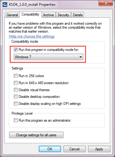

If you face the issue during any installation is possible to avoid it by right click on installation icon -> Properties and choose Compatibility
Please, try also upgrade your Java versions.

Hello Cesar,
thank you for you feedback, I´m going to try it and tell you result on my side.
