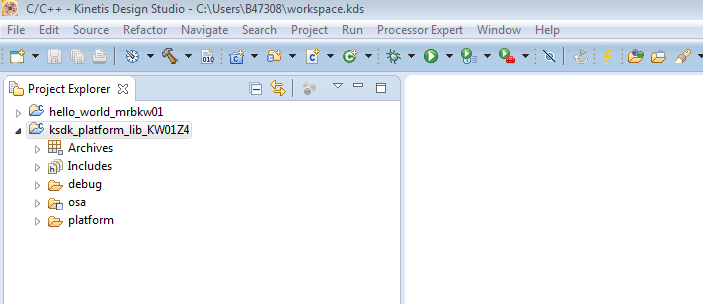

How to build the platform library for KDS for MRB-KW01?
What folder in ...\lib\ksdk_platform_lib\kds contain platform library files for MRB-KW01?

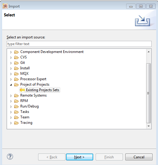

Hi Alexandr:
It seems you are trying to build ksdk_platform_lib_KW01Z4 library.
Please import the
KSDK_1.3.0\examples\mrbkw01\demo_apps\hello_world\kds\hello_world_mrbkw01.wsd into KDS  with "Existing Projects  Sets", then you can see the ksdk_platform_lib_kw01z4, see below picture.
