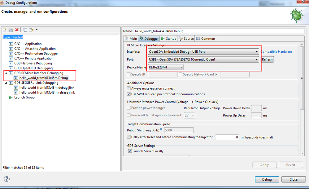

3) When debug , configure like this

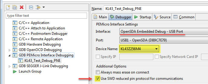

The KDS settings should look like this:
Also you tried to load a FRDM-K22F image. This will not work since that is for a later OpenSDA (v2.1), check this link: OpenSDAv2
Try loading the one Mark shared.

Right now I have successfully (repeatedly) been able to load images into the board via SDA as well as the MBED tools. I then got things so that the debugger would work, and with a little experimentation I found a combination of debug configs that didn't fail (I had to use the KL46Z image in the debugger because the KL43Z apparently is not supported.
