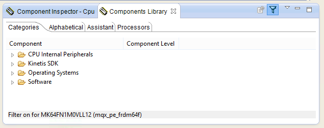

I have created a MQX KSDK plus Processor Expert project using MXQ_KSDK_1.0.0 for the FRDM-K64F board following the tutorial MQX with KSDK and Processor Expert. When created this way the Components Library selections filter out "Logical Device Drivers":
I can turn off the filter and see them but if I try to include the BitIO_LDD component it causes the error "ERROR: This component is not supported in Kinetis SDK project mode" What is the recommended GPIO component if LDD is not available?

You can use the fsl_gpio component instead. This component generates the necessary configuration structures to use the KSDK GPIO Driver APIs.
In fact I just created a new KSDK/PEx project in Kinetis Design Studio v1.1.1 and it came by default with a fsl_gpio component called "gpio_pins". In case you do not have this you can create a new project and copy the component from there.
For an example about using the GPIO Driver APIs, refer to the next tutorial:
Writing your first toggle LED application with FRMD-K64F + KDS 1.1.0 + KSDK 1.0.0 Non-Processor Expe...
