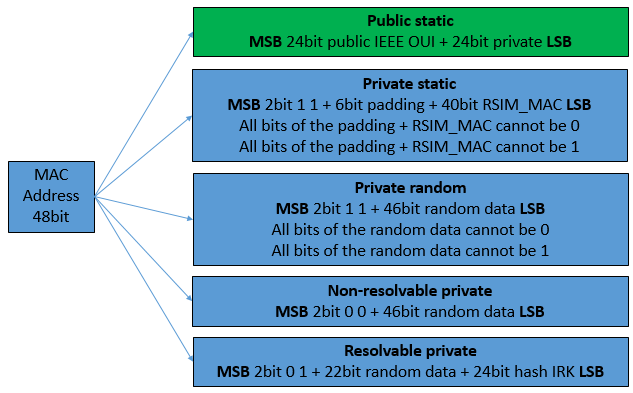

Got confused by these settings:
  file gap_types.h it seems that I can choose some random address.
typedef struct gapAdvertisingParameters_tag {
    bleAddressType_t                    ownAddressType;         /*!< Indicates whether the advertising address will be the public address (BD_ADDR) or the random address (set by Gap_SetRandomAddress). Default: public address. */
typedef struct gapScanningParameters_tag {
    bleAddressType_t            ownAddressType;     /*!< Indicates whether the address used in scan requests will be the public address (BD_ADDR) or the random address (set by Gap_SetRandomAddress). Default: public address. */
typedef struct gapConnectionRequestParameters_tag {
    bleAddressType_t            ownAddressType;         /*!< Indicates whether the address used in connection requests will be the public address (BD_ADDR) or the random address (set by Gap_SetRandomAddress). Default: public address. */
found in ble_general.h
/*! Bluetooth Device Address Types */
typedef enum {
    gBleAddrTypePublic_c            = 0x00,     /*!< Public Device Address - fixed into the Controller by the manufacturer. */
    gBleAddrTypeRandom_c            = 0x01      /*!< Random Device Address - set by the Host into the Controller for privacy reasons. */
} bleAddressType_t;
and set in app_config.c
gapAdvertisingParameters_t gAdvParameters =
    /* addressType */         gBleAddrTypePublic_c, \
    /* directedAddressType */ gBleAddrTypePublic_c, \
Thank you, and

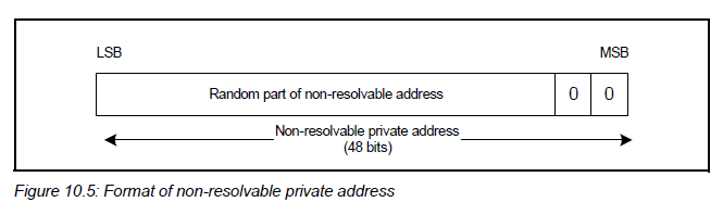

The random device address may be of either of the following two sub-types, privacy reasons:
• Static address
• Private address.
   The private address may be of either of the following two sub-types:
      -Non-resolvable private address
      -Resolvable private address

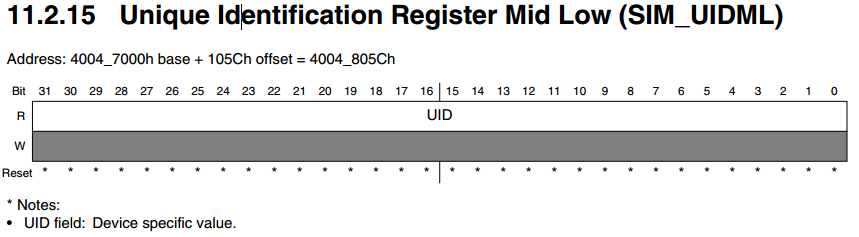

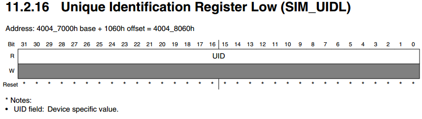

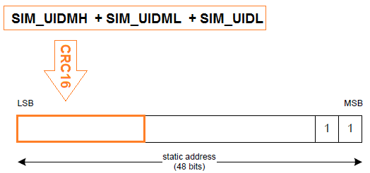

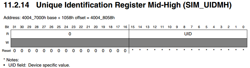

Can we use 16 bit  SIM_UIDMH  + 32bit SIM_UIDML  + 32bit SIM_UIDL (total 80bit) as a unique chip depended key -  Unique Identification Register - to generate a Random Static address ?
MKW40Z/30Z/20Z Reference Manual, Rev. 1.2, 10/2015
Thank you,
Lucian

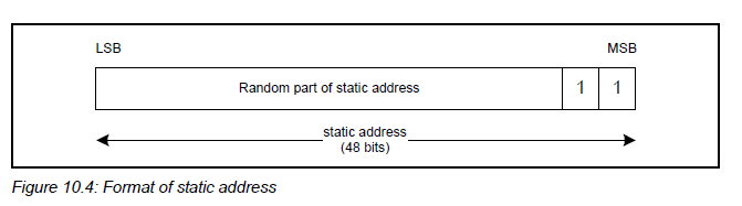

mario_castaneda
Hi Lucian,
You can use that register o generate Random Static address.
Remember:
The BD_ADDR may take any values except the 64 reserved LAP values for general and dedicated inquiries
Reserved Addresses
A block of 64 contiguous LAPs is reserved for inquiry operations; one LAP common to all devices is reserved for general inquiry, the remaining 63 LAPs are reserved for dedicated inquiry of specific classes of devices The same LAP values are used regardless of the contents of UAP and NAP. Consequently, none of these LAPs can be part of a user BD_ADDR. The reserved LAP addresses are 0x9E8B00-0x9E8B3F. The general inquiry LAP is 0x9E8B33.

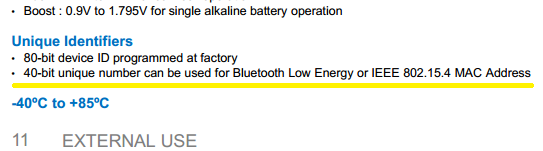

lucianfiran
Contributor V
Hi Mario,
Found a presentation KINETIS W MCUS: BLUETOOTH® SMART AND THREAD
EBV FAE TRAINING - SITGES  16TH MARCH, 2016
on page 11
It states something about 40bit unique number for MAC, do you know something about this ?
Lucian

lucianfiran
Contributor V
What about:
The RSIM MAC Address registers provide a unique ID that is stored in the Flash during factory test
The RSIM MAC Address is loaded from the Flash IFR during the SoC Power on Reset sequence. The MAC Address is a unique ID that is stored in the Flash during factory test.
RSIM_MAC_MSB 8bit RSIM_MAC_LSB 32bit
total 40bit
Address: 4005_9000h base + 8h offset = 4005_9008h
Address: 4005_9000h base + Ch offset = 4005_900Ch
page 988
Chapter 46 Radio System Integration Module (RSIM)
MKW40Z160RM  MKW40Z/30Z/20Z Reference Manual  Rev. 1.2, 10/2015
46.2.3 RSIM MAC MSB (RSIM_MAC_MSB)
46.2.4 RSIM MAC LSB (RSIM_MAC_LSB)
Can this be use as static private MAC address ?

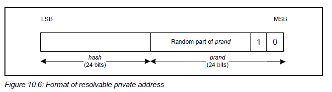

lucianfiran
Contributor V
Hi Mario,
Public address  - IEEE registered, will never change during the lifetime of the device
48bit
  b0  -> b23 company assigned
  b24 -> b47 company id
the  b46 b47 should be different from 11, 00 and 10 - correct ?
As third party using NXP chips can we use FSL or NXP OUI ?
Random Static address - generated every time the device boots up or can stay the same for the lifetime of the device.
 - cannot be changed within a single power cycle of the device.
48bit
  b0  -> b23 random part of static address
  b46 b47  -> 11
MKW30Z has a Random Static Address registers unique for each device - found inside some chip register ?
As chips are provided by NXP, there is a link between the individual chip SN and a generated unique static MAC ?
Is this implemented / supported  in current framework ?
KW40Z_Connectivity_Software_1.0.1 (KSDK_1.3.0)
Private Resolvable address -  generated from an identity resolving key (IRK) and a random number
can be changed often even during the lifetime of a connection
Is this implemented in current framework, you need some paring or extra security settings ?
Private Non-Resolvable address.
Not very commonly used, a random number that you can change anytime.
Is this implemented in current framework ?
The random static device address is also supported by iOS and Android (or Win 10) systems ?
