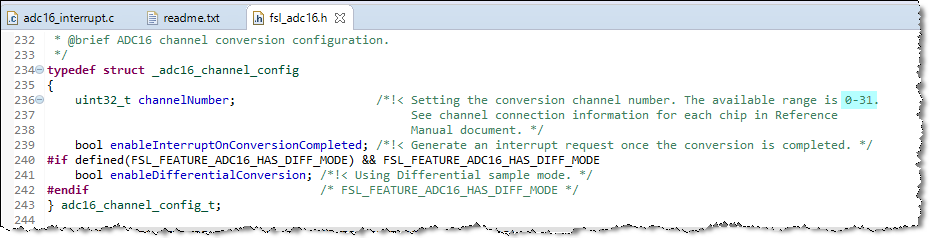

1) The ADC channel are on ADC0_SE11 pin 45, and ADC0_SE6b pin 62.
Are the channel numbers 0x11 and 0x6B?
0x6B is higher then 31, so that does not look correct.

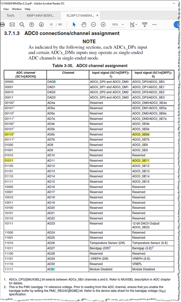

Hi Bruce Graham,
1)
Please check the "Table 3-35. ADC0 channel assignment" of KL26P121M48SF4RM.

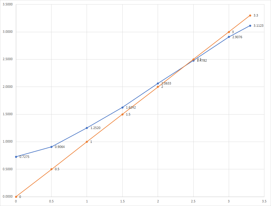

I created a new app using the KL26Z SDK, and the problems have changed.
The ADC problem occurs with:
ADC0_SE6b pin 62   FRDM dev kit J2-12 is stuck at 0x0FFF
ADC0_SE7b pin 63   FRDM dev kit J2-8 is reading noise about 0x0A00
ADC0_SE11 pin 45   FRDM dev kit J4-10 values are not linear
ADC0_SE3 pin 11    FRDM dev kit J4-5 0x0C12  at 2.4895 Volts, 0x0FF5  3.2911 Volts
The values returned from ADC0_SE11 are not linear.
ADC16_DoAutoCalibration() passed.
#define VOLTS_PER_BIT (3.3f / 4096.0f) // Vref / 12 full scale 0x0FFF
fComputedVolts = VOLTS_PER_BIT * (float)iAdcValue;
See values below.
Input    ADC       Computed V
3.3 V   0x0F17   3.1122 V
3.0 V   0x0E19   2.9076 V
2.5 V   0x0C04   2.4782 V
2.0 V   0x0A01   2.0633 V
1.5 V   0x07E0   1.6242 V
1.0 V   0x0612   1.2520 V
0.5 V   0x0465   0.9063 V
0.0 V   0x0387   0.7275 V
Input is Orange. Computed V is Blue.
Is there a known ADC failure problem with the KL16Z SDK?
What is up with the non-linear ADC readings?
